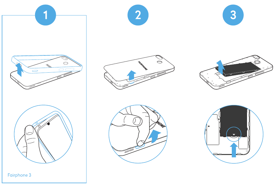

I’m still intrigued by the first image in the Quick Start guide. What is that? I don’t have it.
Do you mean the bumper that was supplied with the FP3 but not the FP3+
This guide shows it is for the FP3, bottom left of the first pair of images. Maybe you have an FP3+ or just didn’t get the bumper which was included by default with the FP3. The bumper is not available otherwise than second hand or custom made.
What you call the bumper is what I meant by ‘bevel’ in a previous reply. Yes I have the FP3+, so I supposed this must have been an extra component of the original FP3. Which is why I assumed that the issue of the oversized case must be more severe with the FP3+, as not having the bumper must surely remove a millimetre or two from the overall dimensions.
