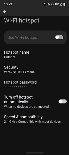

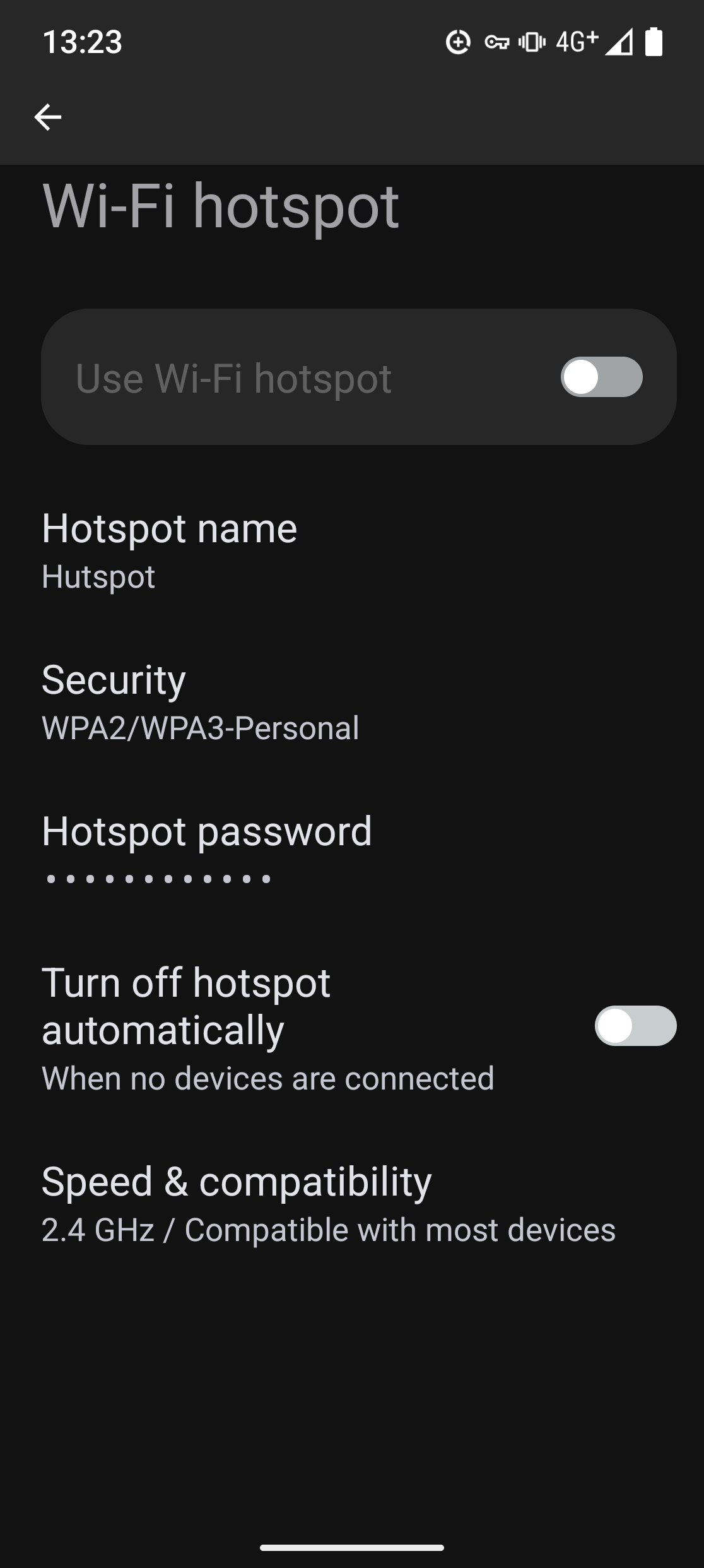

I can’t turn on the hotspot anymore. Other options I can edit.
Hi @Maurits_Muis,
Welcome to the Fairphone forum!
The reason might be that “data saver” (Network and Internet → Data Saver) is on.
I have to manually disable WiFi to make it work, you should give it a try.
Seems fair that I can’t use both a WiFi connection and WiFi hotspot at the same time, but I would have expected that enabling hotpost will disable WiFi, as my previous device do.
