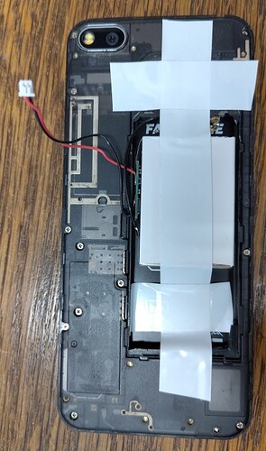

Yes, kind of. I have removed the bulged cell. It started leaking gas, so i quickly selaed it with alimuna tape, now in steel box (voltage was zero) for disposal.
To test run the phone I now soldered in a cell i had lying for another project, to where the original cell was connected in the battery pack:
This is an old type tough prismatic metal can cell, but it have a too low full charge voltage specification compared to what the phone like to charge, so I must not charge it using the phone, instead i kept the for that cell original protection board and connector you see.
The phone seem to run well, and I just now let it remove all data and nondefault apps.
It is running Murena /e/OS 2.9-t, currently chewing on update 3.0.1 from march 2025. - Seems it intend to iterate through all versions… Probably better to load last version through USB of whatever OS next user wants. Or if I keep it. Will see what I decide. Update: I found that clicking the three-dot-meny in the updater app, I could enable it to show all available updates and then select and install the latest, current, version 3.6 :slight_smile:
