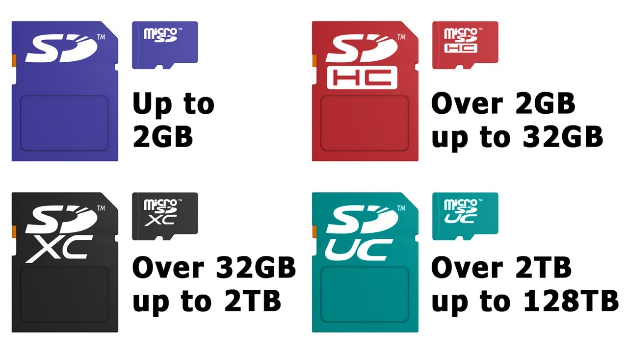

is microSDXC the same as UHS-I?
No, the first one stands for size and capacity range, the latter one a speed category.

You actually don’t need to pay much attention to the UHS speed, it does not impact compatibility (just speed, as Incanus already said). UHS-I just means it’s the slowest type, and the FP5 will work with UHS-II and UHS-III, but just at UHS-I speed.
And regarding costs, you need to figure out if you really need 2 TB (that is almost 8 or 16 times the capacity of the FP5’s built-in internal storage). At lower storage capacities like 512 or 1 TB, you will currently get a better storage per price ratio. 2TB is the maximum an SDXC card can offer, and currently still has the most expensive storage per price ratio.

i have an update for you. If you can hold off on the 2TB and wait a few months. A 4TB version of the Micro SD is slated to have a 4TB version. While the regular is going to have 8TB under UC class cards. The first of this kind. I found out through this video.
Side Comment: Even though this 4TB model would be enough for all my media for sure. This still isn’t enough for backup purposes as my iTunes library itself is 4TB on its own. And my Steam Library is just over 1TB of content. Understanding apple just forcing iTunes users to Apple TV has me worried of all the offline content stored on a raid. If there was a legitimate way to just have it everywhere I go would be nice if disaster strikes. Then I can recover my data off the SD card on a new setup no problem. Storing data like this would indeed be nice for not having to pay for unnecessary cloud subscriptions. And just Having a NAS right at home means no latency, lag, or even Downtime. It would have been nice for the 8TB version to be micro SD. But its still years away. This is all just my opinion as more and more wildfires plus other disasters continue to get worse because of climate change. All those memories are valuable with all those hours spent watching content and gaming. I’d sure hate to lose it and become dependent as if the service will still be here down the line. That’s the digital future I’m afraid of in a nutshell.
Anyone know if SDUC cards would be usable/compatible in any Fairphone at all?
Fairphone’s Support article does not address this. While it states the SDXC standard maximum of 2TB as the ceiling for the FP5 and FP4, it also states a lower capacity of 400 GB for the FP3 while I am currently using a 2TB SDXC card in my own FP3.
