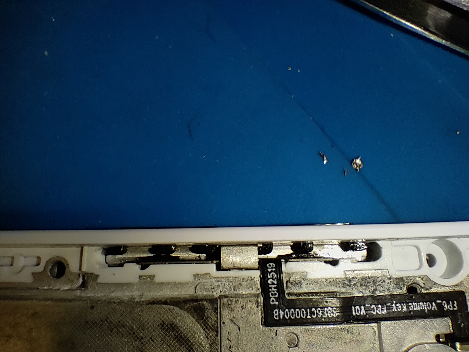

If you need it, I have the print files for button replacement, fixed the stucking for me. Attaching a pic of how the buttons look inside
Yes please! That would be fantastic. I’d love to repair it myself once I have the right screwdriver and be able to sort any little issues like this myself. Nice to see someone else had the same issue and fixed it so thank you for replying
Since this seems to be an issue I should be prepared to encounter with my FP6 at some point, I’m very curious to see whether it works — please keep us updated.
