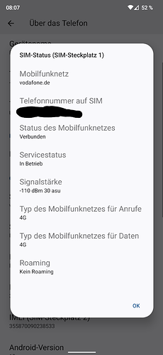

My settings are as in my screenshots.
I did a test now.
I gave myself a call to another phone. speakers on on both sides. I could hear myself.
And in parallel i could surf in internet. check mails, etc…
both works fine in parallel. WLAN off, only 4G data and phone connection
