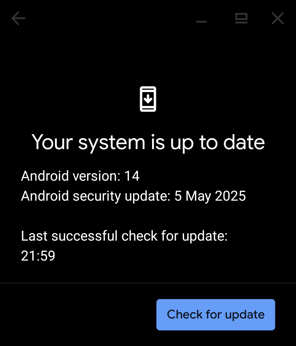

@JohnnyD, how have you updated yours? I don’t see an update at com.google.android.gms/.update.SystemUpdateActivity:
Though, I do get a keystore error upon invoking a check:

You cant update the Camera manually
and I also have version 6…with FPOS Android 14 however 14.0 at the end
@JohnnyD you dont use FPOS?
Are you on stock rom? On my FP5 with stock A14 and latest/May update:
com.fp5.camera
v6.00.04.0038.16.0
@yvmuell and @k3dAR No I’m not on Stock-ROM/FPOS. I’m on /e/OS. But I was under the impression that this camera app comes directly from Fairphone, in other words is exactly the same app which they deploy in their stock OS. Why would Fairphone hand out different versions to /e/OS and even withhold potentially better versions for their own OS?!
Another version number doesnt mean better or worse. Did you check the linked topic also to the e/OS forum, where you might ( I dont know) find details? Here I would say its rather off topic,unless @rokejulianlockhart wants to discuss further.
I searched a bit and now I understand…
You have Camera App from stock FP4, same appid and version:
https://cweiske.de/tagebuch/android-write-system-partition.htm
Edit: not you, but rokejulianlockhart :slight_smile:
@k3dAR, I do? That’s untrue – the package ID contains fp5, as aforementioned. (pm list packages -f | grep fp5 returns package:/system/priv-app/FPCamera/FPCamera.apk=com.fp5.camera.) Additionally, you and @yvmuell have stated that you’ve the same version installed. Please elaborate.
@yvmuell, you’re correct that I’d rather get back to the problem at hand. Consequently, I’ve asked at /e/OS’s forum for an explanation to this discrepancy:
Incredibly, @JohnnyD appears to be correct that his version is also from FP themselves:
I suppose I should contact FP ZenDesk about this, but I just can’t be bothered to wait for 4 months for a response. I’ll mention if I eventually do, unless anyone else here experiences the same problem with their installation. I’ll remember to check the camera version next time the OS updates, though.
Sure it is, its just a bit unclear why @JohnnyD claims to have on their e/OS Fp5 v7 which seem to be the FP4 version. FP4 and FP5 camera app are not the same.
@yvmuell, thanks for the clarification. I’d misunderstood, thinking @k3dAR meant me.
I think there have been some misunderstandings, on all sites… so…
I didn’t claim anything. Agreed, I could have been more specific from the start in retro-perspective.
To be clear:
FP4 → /e/OS (Android 14, March 2025) → v7
FP5 → /e/OS (Android 13, March 2025) → v6
But it didn’t seem relevant to me at the time since I thought and I’m still thinking it’s the very same app we’re talking about. I did say there are different versions, though. Clearly meaning those apps are not exactly identical. If they were, why would I suggest up or downgrading? From my point of view it’s the same base app, only called differently and maybe configured a little bit differently. But for the vast majority of source code I’d say it’s pretty much the same.
In that respect I was saying there might be better app versions because all versions I use seem to work indeed better than the one the OP meantioned. I was also wondering why there are so many versions in the first place. I would have thought no matter the OS or phone version the app version would be everywhere the same. Hence my question…
However, I did confuse the Fairphone camera app with the /e/OS camera app. So my appologies. Consequently up and downgrading indeed turns out to be much more difficult now.
@JohnnyD, if you’re referring to com.fp5.camera, you have no way of knowing that, bar decompilation (and I believe it would breach ToS for me to even instruct on this). [1] A major version increment usually represents backward ABI incompatibility, which would indicate the opposite of your presumption, because that’s generally caused by major refactor.
