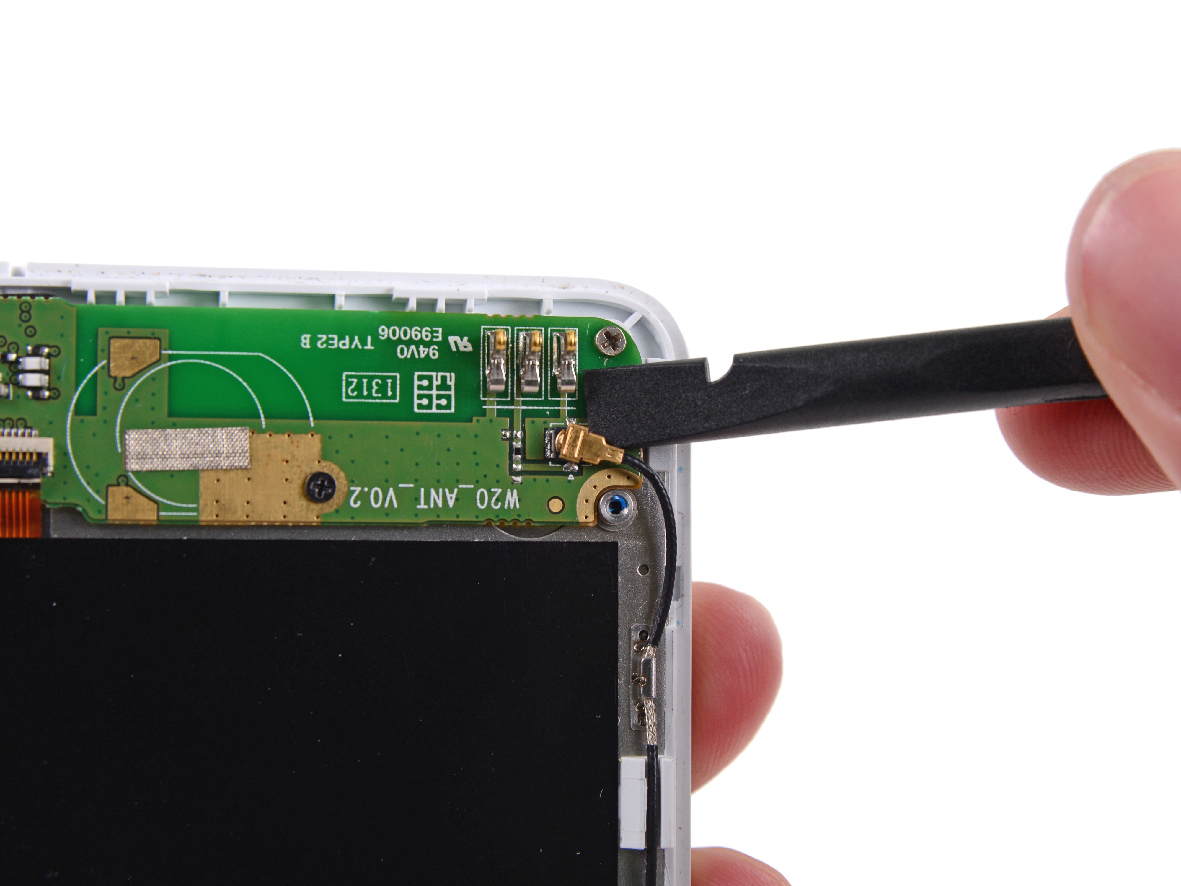

One last thing to highlight is that I have had this issue since buying the phone. I later cracked the screen and replaced it myself. When doing this, I noticed that a screw was missing from the original build (the black screw in the middle of the wifi daughter board - https://d3nevzfk7ii3be.cloudfront.net/igi/xSxRL2PnPVDfB5aE). Is there any way this could affect the phone signal?

Missing screw at my FP1U too.
I’ve written FP Support, no answer as yet.
@EvaS after discussing with Fairphone support it was confirmed that the
extra screw isn’t required. I guess that the iFixIt team thought the scree
was missing and added it in. This is why the screw in their photo is
different.
Oh, thankyou, it’s ok, now I know it :slight_smile:
