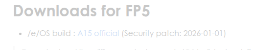

Thank you for all you r answers. From what you say I can safely conclude that I have involuntarily bricked my phone. I have flashed /e/OS 3.3 onto my phone. I have no idea how something like this can happen at all: I swear an oath that when I followed that link on the FP5 /e/OS install page (see screenshot obove) stating that what I would find was on SPL 2026-01-01 I found to .zip archives of /e/OS 3.3 with suspicious file names as for the SPL dates. I trusted the info on the preceding page, however, thinking that they know what they are doing.
And after having read your posts, I went there again, and lo and behold: all of a sudden there were three .zip archives, the top one being 3.4!

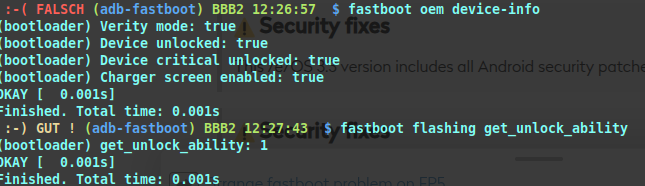

I am downloading it at present, and I will try to flash this onto the phone now. Hopefully this will work. My Fastboot output is as follows, which looks good to me:
Report: After the download was finished, I tried to flash /e/OS 3.4 onto my phone. The script got stuck a couple of times in different places, but I aborted it and tried again and again - seven times in all, but my perseverance paid: I got it to run through to the end once, and now I am on /e/OS 3.4!
