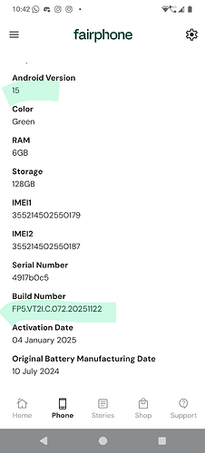

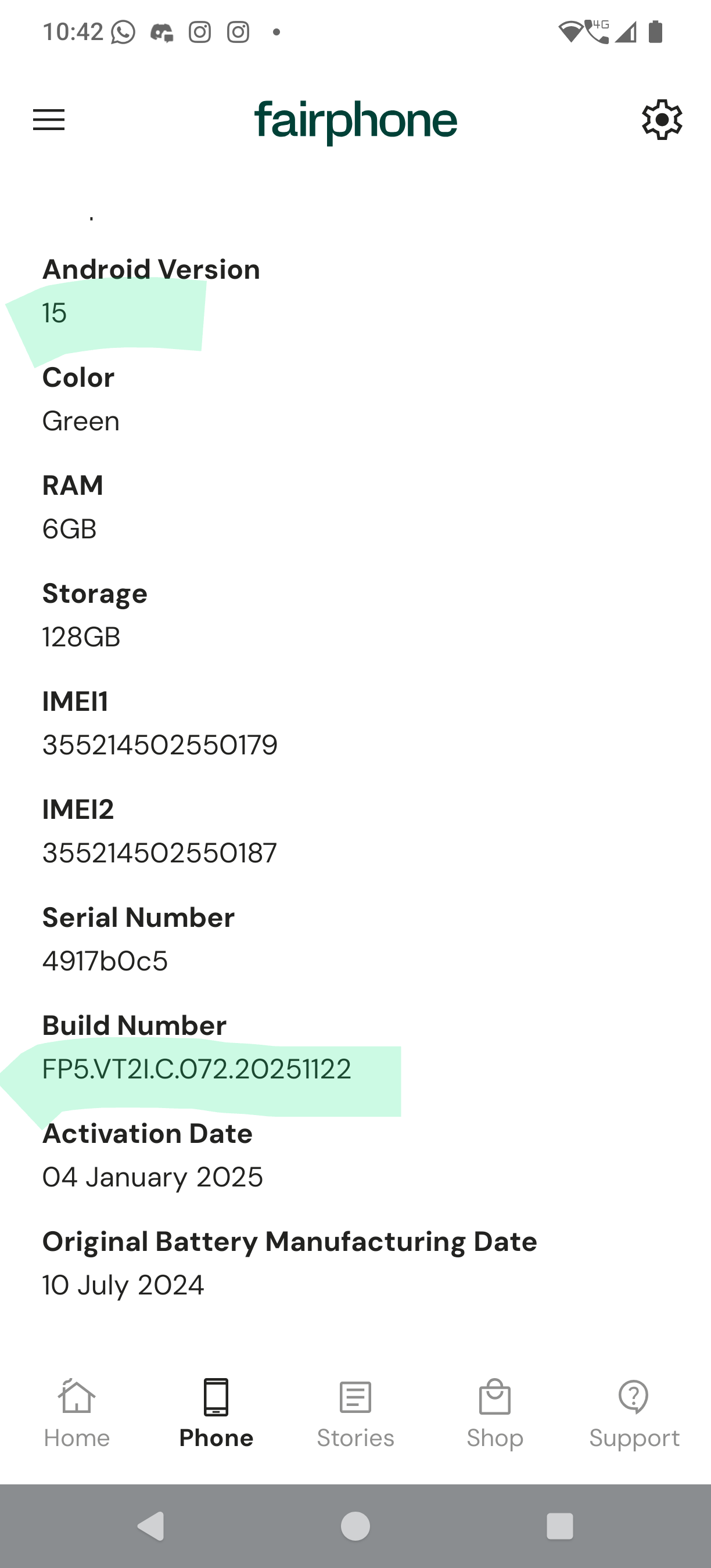

Thank you for this piece of information, but this is exactly the setup I am running (see screenshot).
Is there something specific I should do?
