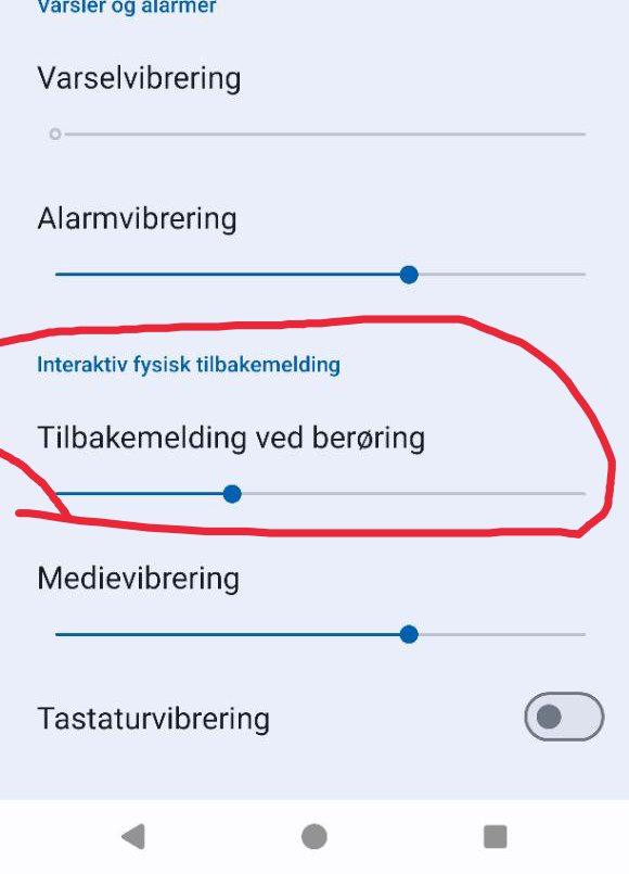

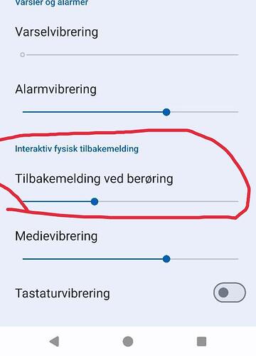

This is not exactly an issue, but I noticed a change in how vibration feedback works for the fingerprint sensor now.
It seemed to have stopped working, but it was off because I had vibration feedback from touch interactions turned off.
I guess this makes sense, but I did not mind having vibration feedback always on for the fingerprint sensor, and off for touch screen interactions. Ideally it would be two separate settings.
