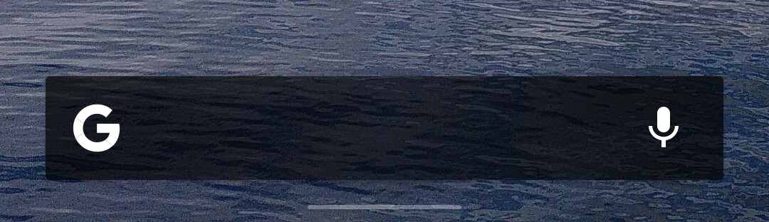

Thank you for the suggestion, I got the update after removing the SIM. Anyway, full gesture bar still has a bug, they only moved a little up the icons row and the navigation bar shows both the two buttons and gesture layout (photo attached).
Edit:
Today I change the wallpaper and bug disappears (photo attached). FP should fix this bug but changing the wallpaper actualy is a workaround.
