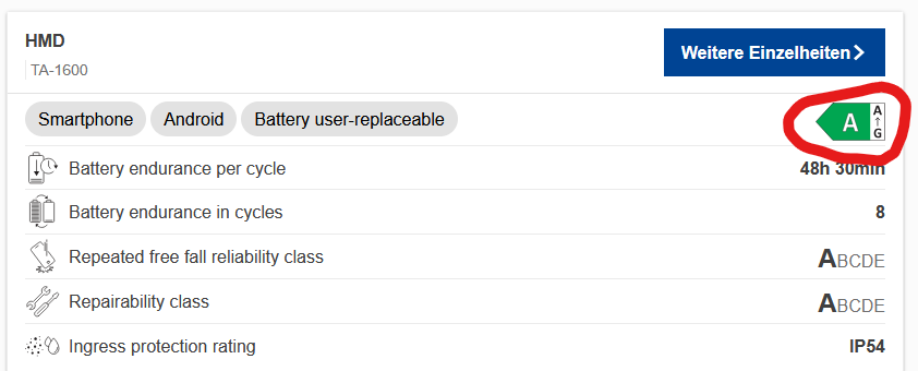

With an overall score of B for the FP5 there are 10 smartphones with a better overall A rating in the EPREL database (6 of them by HMD).

Hello, what do you mean by overall score, I thought a letter just referred to the energy efficiency?
Can’t see FP5 in the database, and the link from the pdf is not working, am I missing something?
PS. I have been checking on a mobile myself, usually get better search results on my computer;-) so I can double check in the afternoon
Yeah, you’re probably right, the big A in the screenshot seems to be just the energy score, not some combined score. My bad.
And yes, the FP5 doesn’t seem to be listed yet. No search result so far and https://eprel.ec.europa.eu/qr/2378858 from the PDF above currenty says “not found”.
