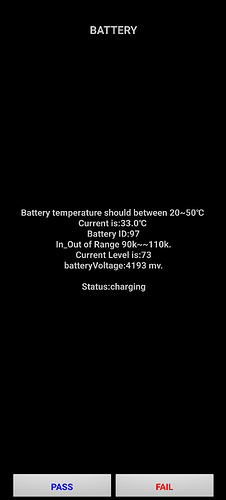

Yesterday I entered the maintenance menu using the Android “secret code” *#*#2886#*#* and I got the following result (it was charging at the office at that time):

Just to let you know how it finished.
After cleaning the USB port with a small brush (the ones used to clean orthodontic appliances), some contacts cleaning spray and some compressed air spray the smartphone started recharging reliably but Android Auto kept not working.
After replacing the USB port, also Android Auto started working again so the problem is now solved.
