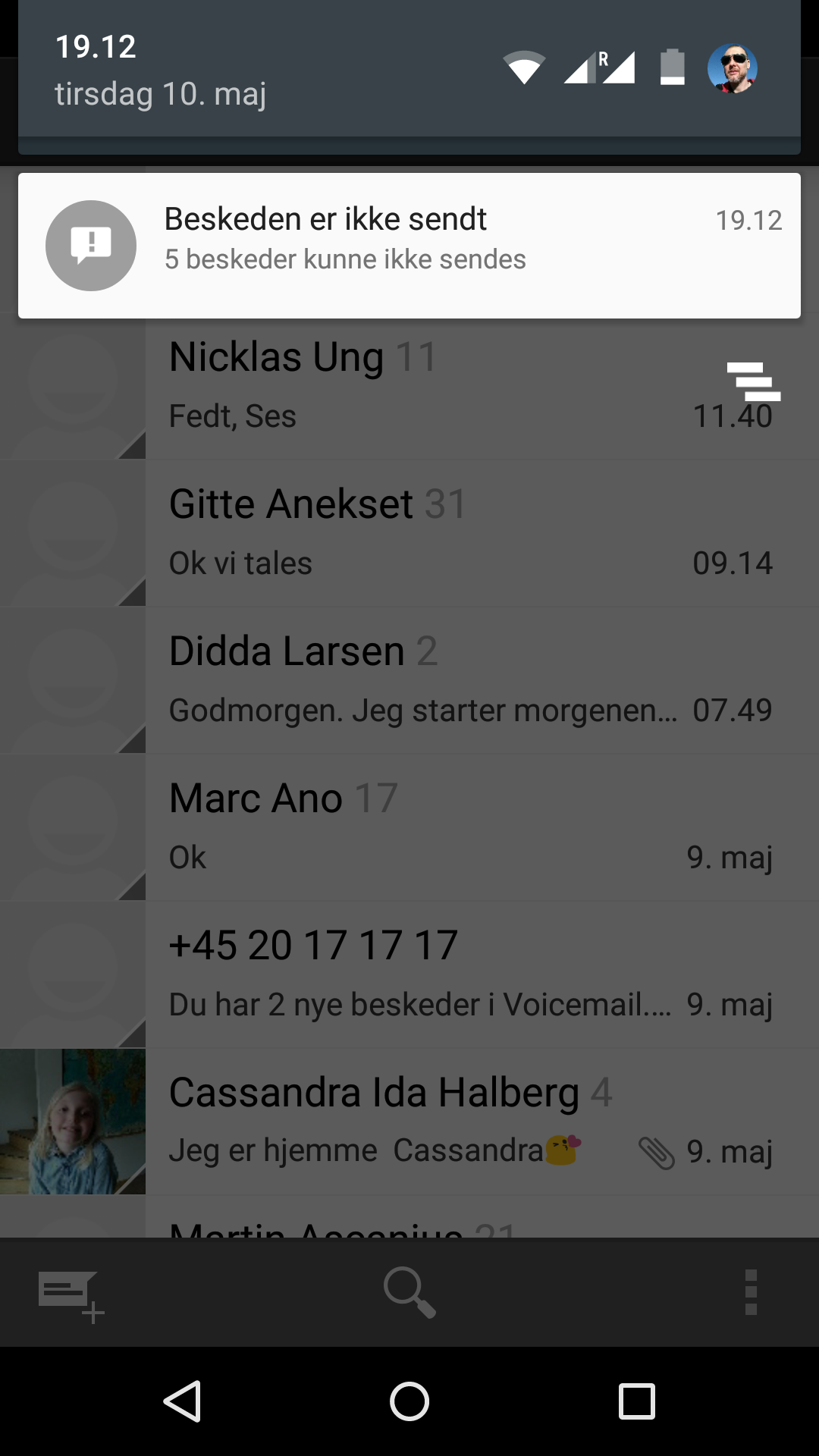

Okay, its a FP2 software 1.2.8.
When i open the message app (standart android), i get a notification saying: ā€˜message not send, 5 messages could not be sent’. (See screenshot in danish). These massages no longer exists in the app, i deleted then long ago. The problem started with some of my first messages, I can’t say if it was a certain kind of messages, but it has not been a problem since sending - only the same notification repeting.
I hope this clearifies it… Let me know if you need more info
