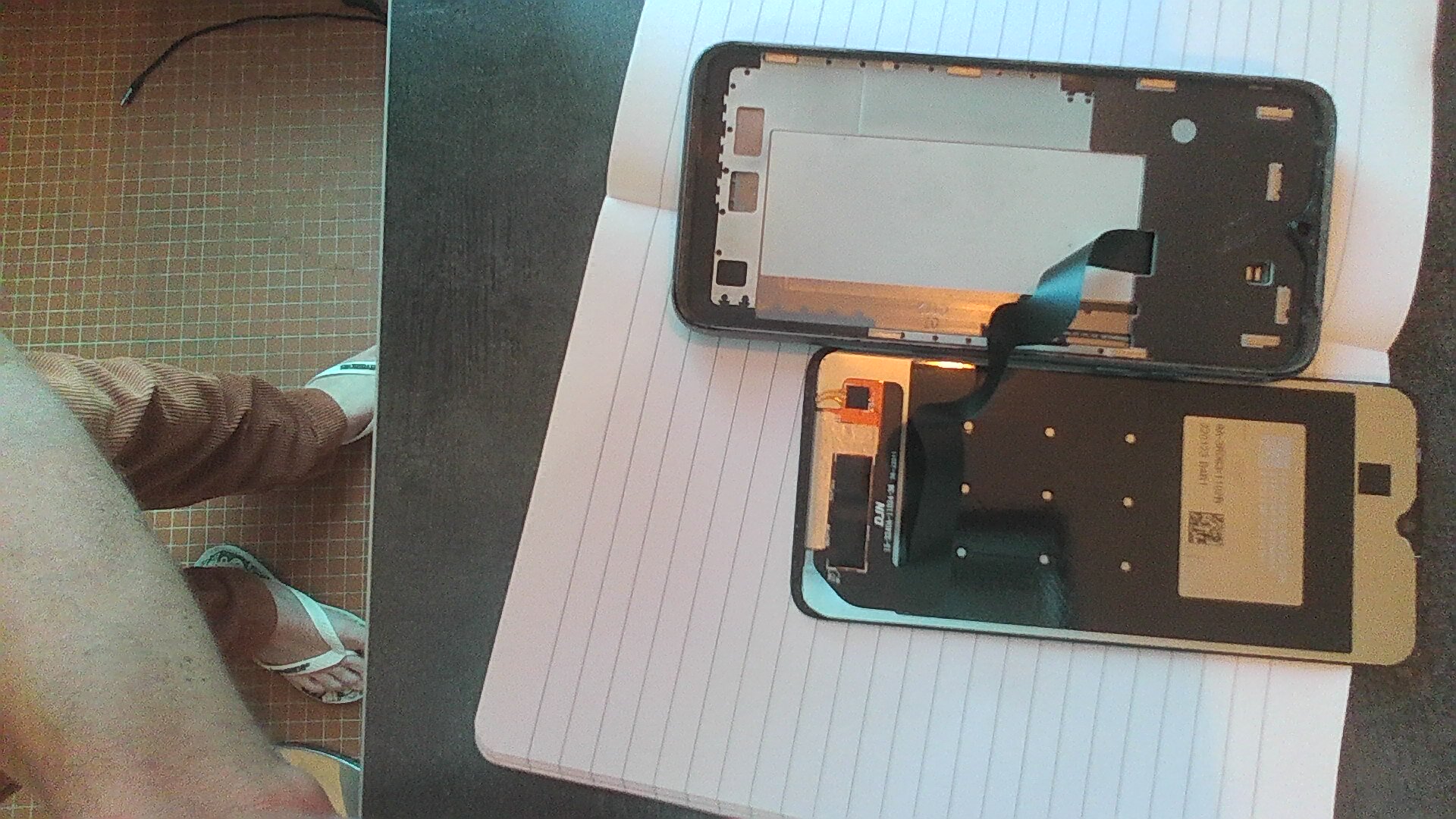

Screen unglued from the plastic frame FP4
The screen this week poped out ! Mostely due to the last fall on the ground.
It remind me of the old Nokias ! Kudos fairphone. Fall apart and then you have to Lego it back to work :smiley:
It is not unscrewed from the back I never dismentelled my phone since I received it 2 years ago.
I thought it was unscrewed, but no, I think it is unglued from the plastic fram the screen is glued to.
Then this plastic frame is screwed…
My plan to repair this weekend is to dimentel the phone and apply a little tiny glue on the LCD back to stick again with the plastic frame…
Any idea or directions to follow ?

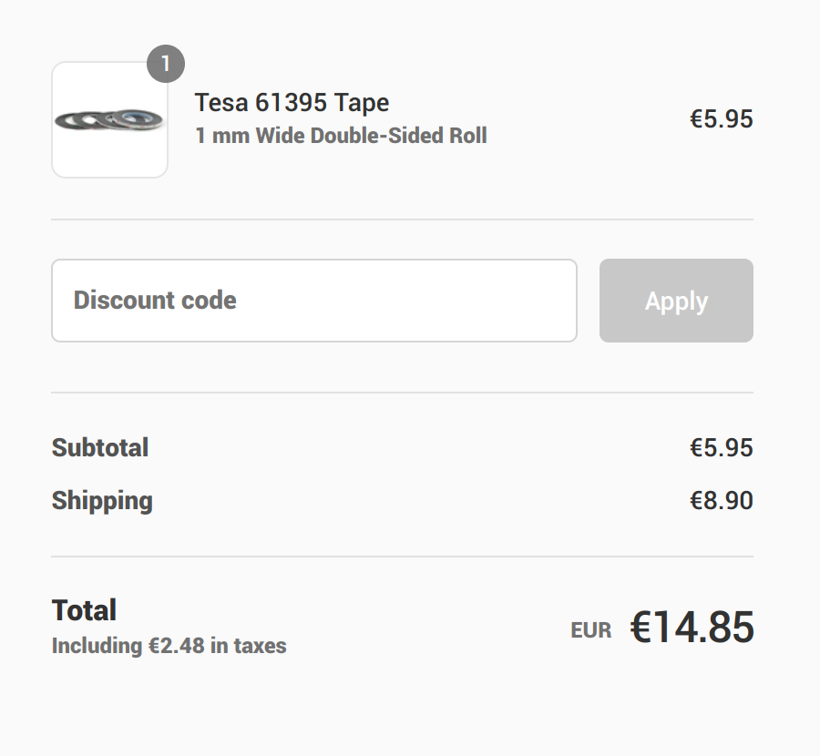

Now its a little over priced 15€ I am going to use 10 cm :smiley:
Do you know of any other tape that would work ?
You can search for the 61395 tape at electronic stores near you, they likely have it or can order it to avoid shipping costs. It’s also a large roll so you will be fixing your phones and friend’s phones for a long time, so a good investment in my mind.

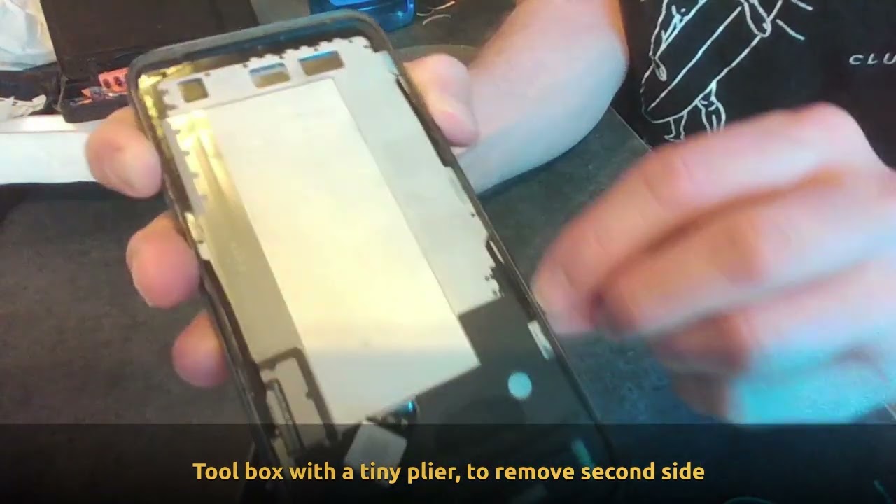

I am wondering how the screen was originally fixed to the small plastic frame on the FP4 ?
I don t see glue or tape on either face of the screen…
I am asking because, I will want to place my tape at the same place as before it broke :wink:
