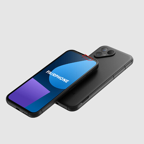

These sensors are above the screen, so you just need to put your thumb onto the top of the screen to cover it.
@Martin_Anderseck now i also confirm: your second workaround too work for me ![]()
while FP5 LCD is ON, cover top sensor for ~4-5 seconds and uncover…

I usually reboot it to fix it, although I will continue to try the “cover the sensor” trick. However, this doesn’t always seem to work for me. That may be because I’m confused about the sensor location.
Is the light sensor part of the screen based camera ? Or is it the pinhole on the top bezel? If someone has a picture they could stick on here that would be useful.

Brilliant. Thanks Meaghan.
