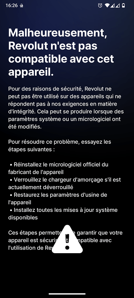

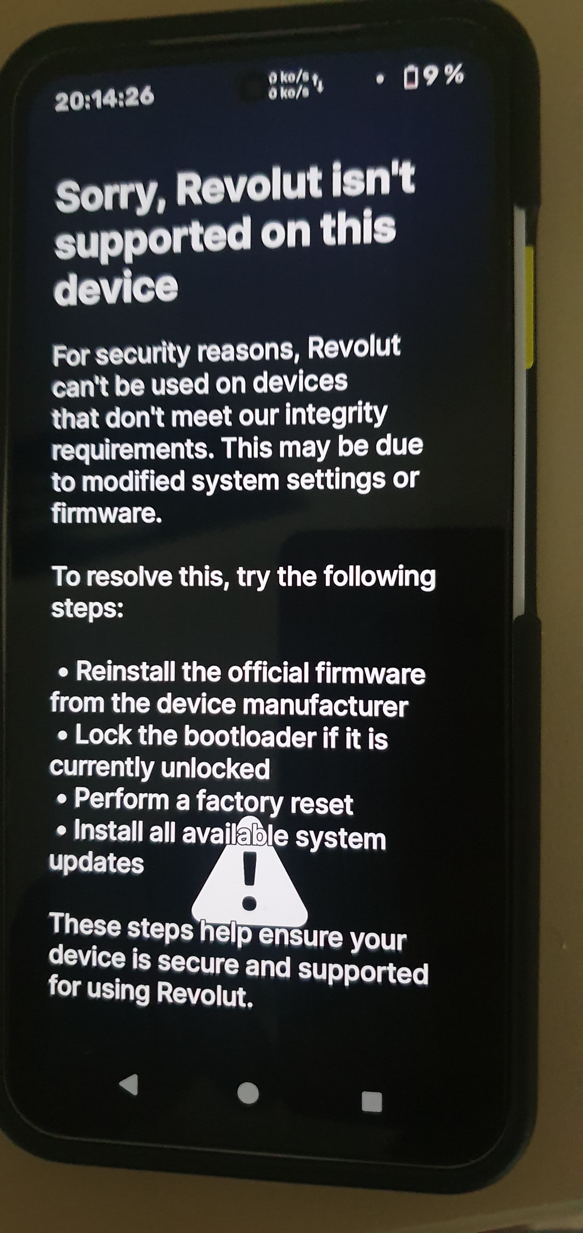

I just bought a Fairphone 6 with /e/OS Murena preinstalled, and the Revolut app is blocked (see photo).
Message: “Revolut isn’t supported on this device, integrity check failed.”
The device is not rooted and everything is up to date.
