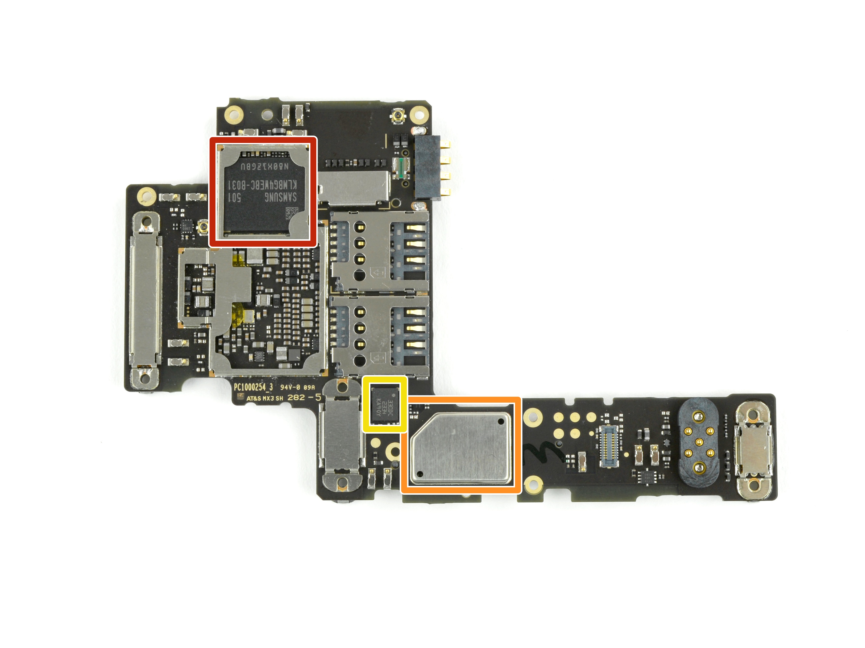

I see that:
https://d3nevzfk7ii3be.cloudfront.net/igi/sZZp41ImYSa4ribZ
Someone try to extract NAND flash unit and read with some like this ?
Yes, this works. But you’ll need a some k€ reflow soldering station to get the flash out. Would be easier to call Fairphone and ask them if they could repair your phone…
