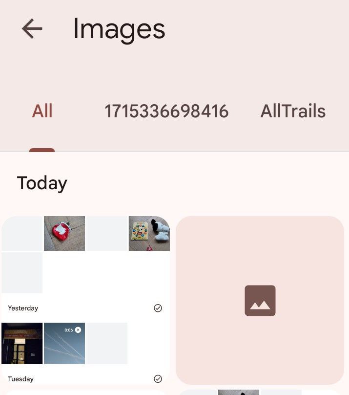

I’ve been having issues with taking photos quite often lately. I have a fairphone 4 and every so often when I take a picture either it just doesn’t save (this happens too often for me to think its just a user error) or it shows as a white file (in Google Photos) and in the file app as just an error image. Anyone else having this issue and perhaps have a fix?
With the stock “Kamera” app I have a similar issue. In the directory DCIM there is a 0 byte file with error indication. In DCIM there is a sub-directory called “Kamera” and the photo can be found properly in that directory. However, if I want to look at the photo from within this app, it tries to show the file from DCIM.

I’m having the exact same problem, with same fie paths (except folder is named ‘Camera’, not ‘Kamera’) I’m guessing the app creates the empty file as it is trying to find it.
Looks like previous photos were saved in the ‘Camera’ folder. Seems like easy fix, wrong default file path somewhere.

I did all of those things. Issue isn’t in this case that it’s not saving the file. It saves it just fine. The app is just looking for the photos in the wrong folder.

I checked the subfolder “Camera” within the DCIM folder but it also contained the 0 byte error files so I’m not sure if we’re on the same page? Or am I looking in the wrong place. Because so far everytime I’ve had the error with a photo I haven’t been able to find it anywhere else in a subfolder
