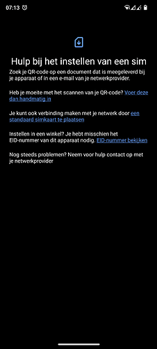

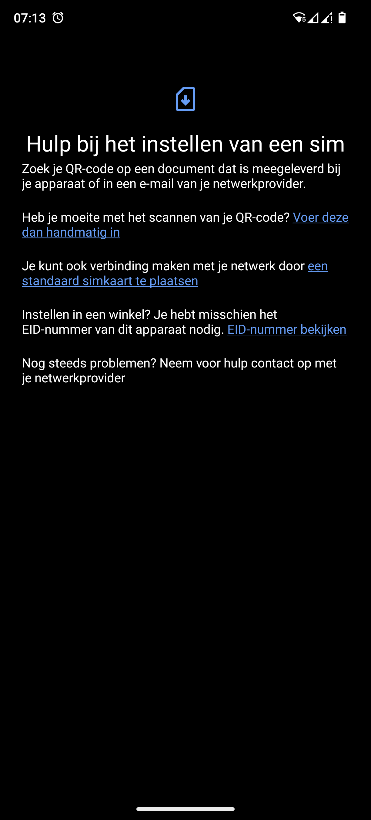

It’s congstar and they said that my phone expects other informations in the QR-code and that suggests that the phone is an US-one. You can type in the qr-code by hand but what my provider gives me isn’t accepted by the phone. Is it possible, that the eOS-rom that was used by Fairphone is an US-one?
Edit: my phone expects a code beginning with 1$ or LPA:1$, but the code from my provider looks way different.

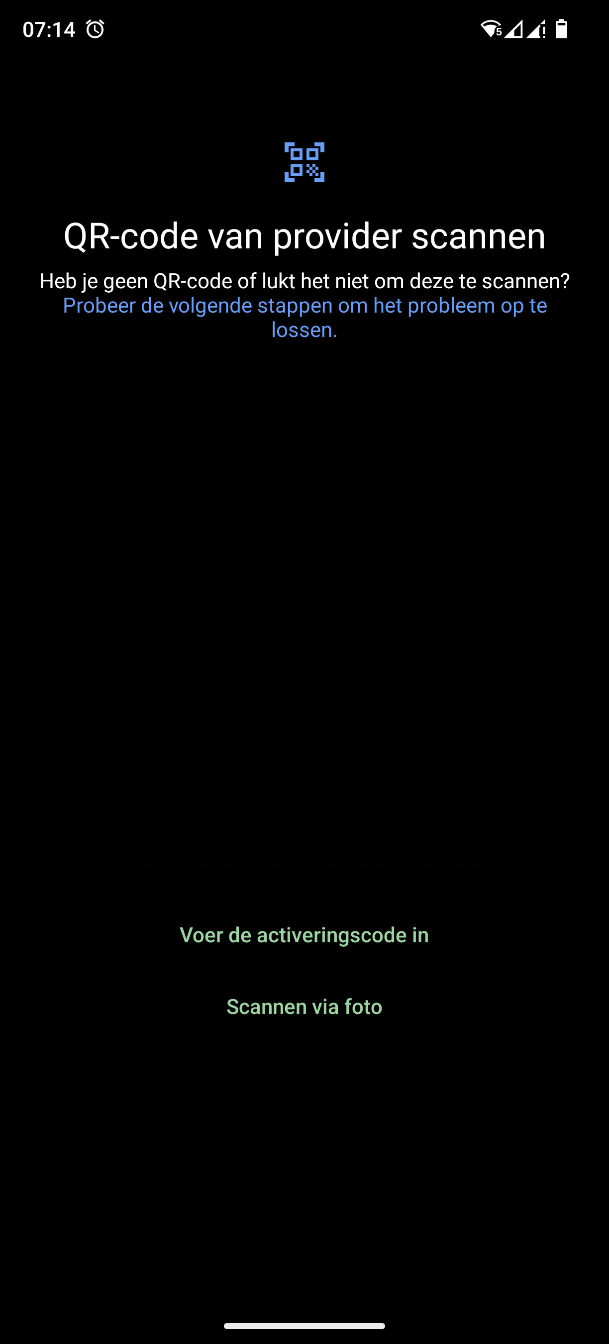

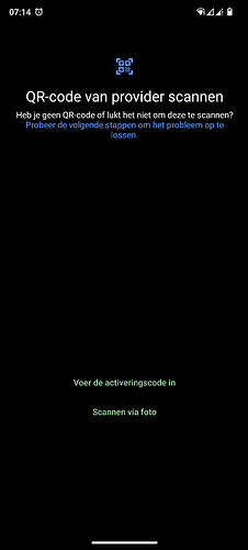

Okay, thats strange. It just doesnt scan it. So I looked what code the phone expects.
I used the qr-code from congstar on an iPad and it worked just like expected.
Sadly I have no clue whats wrong with the FP5. I’ve tried it with two different FP5 with eOS.
So it looks like an issue with eOS and not the Fairphone itself.
What does that mean? It doesnt focus to scan?
When I hover the camera over the qr code nothing happens. I’m talking about the qr-scan function within the “add esim”-menu.
