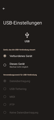

Hello,
my Fairphone 5 has a data transfer problem: It is not possible to synchronise files with e.g. a notebook or a car for e.g. Android Auto (if Bluetooth is not possible) if the notebook or the car has a USB-A connection, i.e. no data transfer from USB-C (on the Fairphone 5) to USB-A. I have tried several cables, it is the Fairphone 5 and not the cables. It works with an Oppo smartphone.
Interestingly, data transfer from USB-C to USB-C works with the Fairphone 5 with most cables.
Is this a known problem and can I do something about it? Or do I have to contact the retailer or better yet Fairphone directly?
I look forward to your feedback!

Did you try to replug the A to C cable in the phone the other way around? Usually for USB2 connections it doesn’t matter but if you use USB3/4 cables and the A to C cable is a passive one, it will only work (with those speeds) if plugged in a certain way (one or the other).
Hello, I have also tried this. Unfortunately, when I turn the USB-C port, no data connection is established. Are there any other options? Otherwise I’ll have to get in touch with Fairphone. Has anyone had similar experiences? Is the problem solved by replacing the USB-C port or does the smartphone have to be sent in because there is a mainboard error?

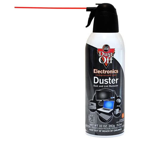

Try to use contact cleaning fluid, or isopropylic alcohol to clean the FP5 connector.
Shut down and battery out.
Put some fluid on FP5 USB-C connector, little amount just enough to wet contacts (use a pencil), then use a new USB-C male/male cable to perform connection/deconnection multiple times in a row, then put some fluid again with pencil, and then dry it with cleaning air.
Do this 1 to three times and then test connecting again to a computer.
If you use protection case, beware that some have bad cutting around USB-C connector and prevent full connection, which will not be a problem at first, but once connector is getting old and dirty, will prevent good connection then also.
I did exactly what you suggested now, but it didn’t help. The phone was also never exposed to extreme dirt or humidity and the connector looked clean before. Data transmission only works with high quality USB-C to C cables, no thin versions that are actually only USB2 version or USB-C to A cables. It seems as if the data pins for usb2 transmission are defective.
