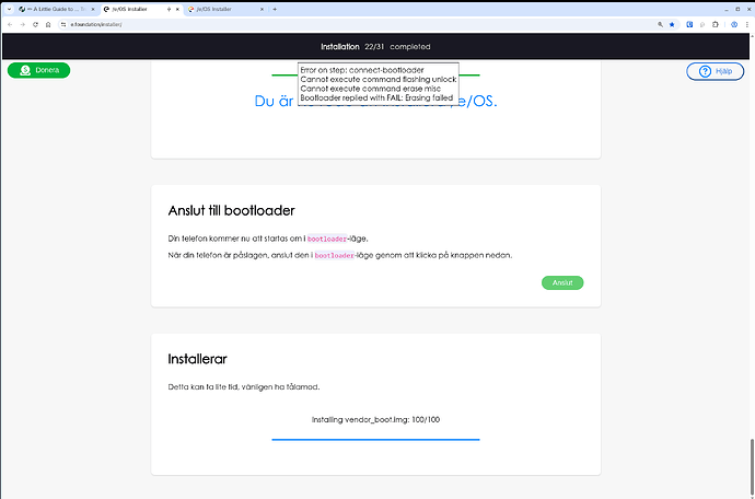

I started the /e/OS Installer but it is unclear if the instructions are wrong in swedish or what is going on after i choose the step after the files are downloaded (again). Maybee do some kind of sha256 on the downloaded file so we don’t drane all your data plan, because I have downloaded step 8 several times now. Step 22/31 or before is wrongly translated it should say fastboot but it says bootloader. This is the error i get in chormium Installation 22/31 completed:
Error on step: connect-bootloader
Cannot execute command flashing unlock
Cannot execute command erase misc
Bootloader replied with FAIL: Erasing failed
There is no way to retry from here, it does not have a green button like previous steps.

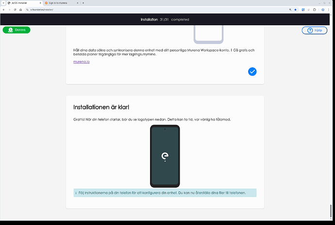

Actually I did this to the script and it finished, i changed the erase line with misc:
# ERASE_IMGS=“misc userdata metadata”
ERASE_IMGS=“userdata metadata”
Results:
INFO: Done. The device will reboot now.Rebooting                                          OKAY [  0.000s]Finished. Total time: 0.050s
INFO: You can unplug the USB cable now.

It turns out that I did not read the instructions correctly.
The new fastboot mode confused me. So the install i did was in the mode that you do by navigating to fastboot. The scripts points it out:
Info: Your phone is in fastbootD mode
So I’m now running the script after holding down “Volume Down + Power” and I get:
Info: Your phone is in regular bootloader mode
Sending 'bluetooth_a' (812 KB)
Now when I start the script it starts but it is stuck at the first file. There is no progress like when I was running it in fastbootD witch was lightning fast but ultimately not the right way.
What am I missing now that is hindering it from progress?

Hi again,
I rebooted my computer, formated the device from fastbootD and just tried the script several times.
I did the webinstaller again and you know what? It worked!
Everything is fine, I don’t know what made the web-script run all the way this time.
Thank you for the support.
