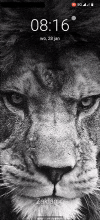

Hi,
When I try to open the network settings on my phone, it closes immediately after opening.
If I open it a second time, it stays open. This happens every time if the settings haven’t been opened for a few minutes.
1000068088
I’ve had this strange issue for quite some time already, and the latest update didn’t solve it.
I’m wondering whether this is something that just happens on my phone, or if it’s more common.
Thank you for your response.
