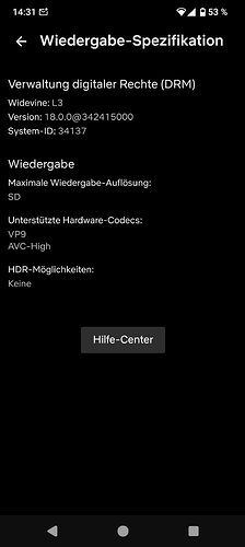

Netflix only shows Widevine L3 on FP6
I already reinstalled, cleared cache, etc.
DRM Info shows L1 support.
Am I the only one with this on FP6? It was fixed on the FP5 with a software update. Maybe this issue needs fixing again on FP6?
Can anybody from the community confirm this behavior?

Just to link the FP5 topic
and confirm the finding on the FP6
Thanks @yvmuell to confirming this. @my_fairphone it would be good if maybe someone from fairphone could look into this. Maybe the “issue from FP5” was reintroduced in FP6?

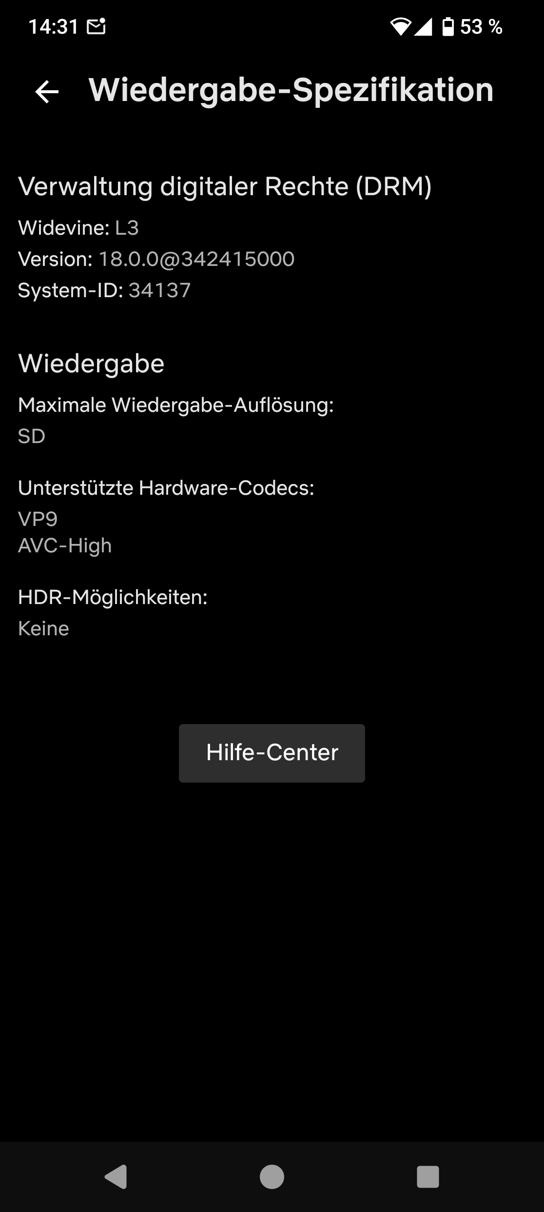

I trust the image is from your FP6 which is showing L3 support not L1 in Netflix app?
“DRM Info shows L1 support.” That is what was put in the original post so a bit confusing as I thought not showing HD but showing L1.

Yes it is.
The App DRM Info shows L1 which is what the FP6 should have in general
I believe this is the DRM Info app you refer to:
