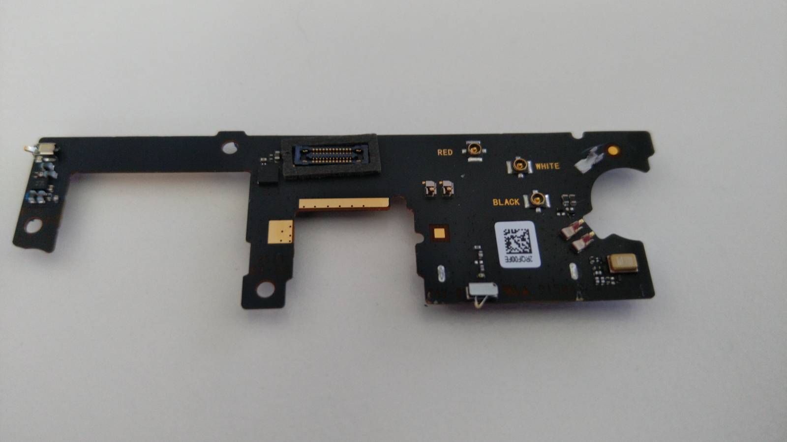

I agree here. My submodule under the loudspeaker is broken. I have identified the problem, After I dropped the phone on the floor the PCB was damaged. I wanted to replace this module, but there is no module in the shop. This damaged module causes that the microphone does not work. I contacted support and since one month I am on hold, i. e. no support. Since one month I am without a microphone on a phone in 2026, a phone from a company that promises repairability. It’s a HORRIBLE experience! I own the fairphone 6 and it was not cheap. I agree with the statement, change the phone and never look back. Change to the Chinese, better phones, cheaper phones. Europe consumer market is dead!
