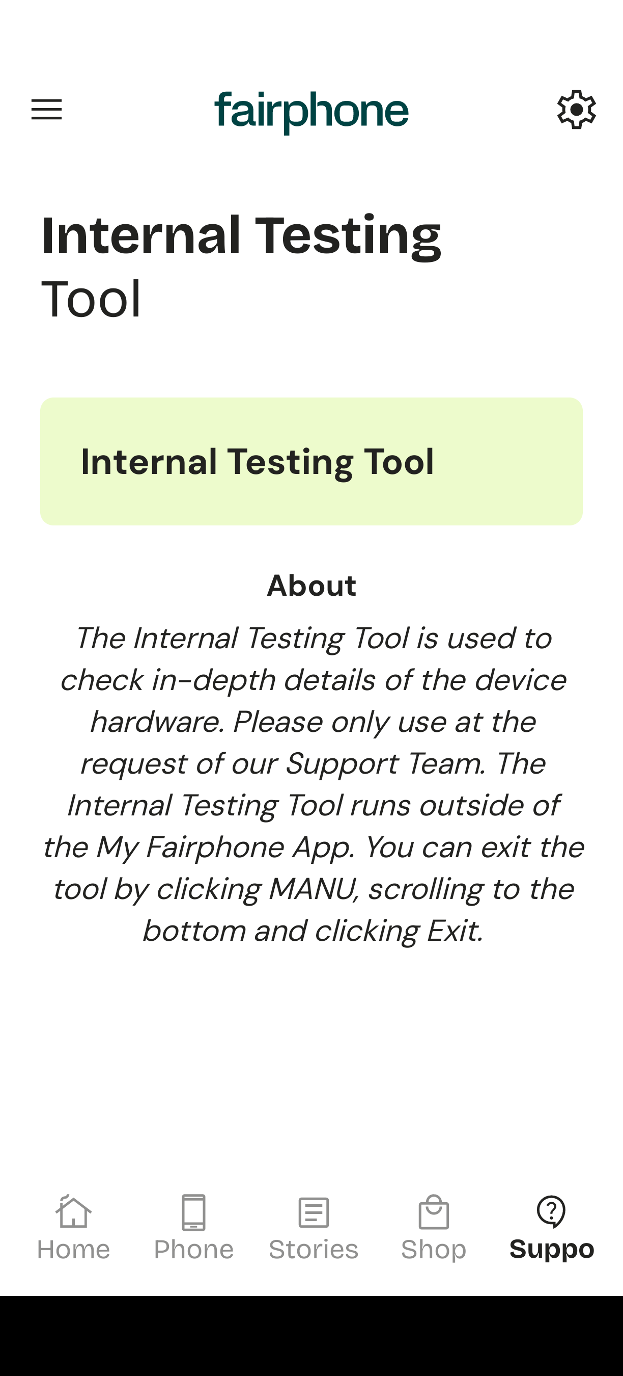

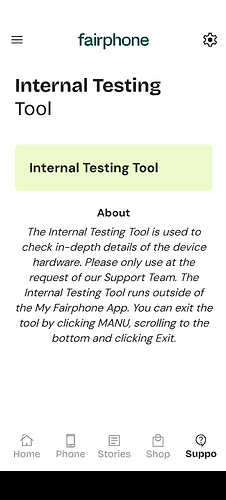

Hi, I don’t use the SD card but I have seen this category in the internal testing via the app.
I have also run the troubleshooting via the form on the website but it did not bring any in-depth testing
However, the internal testing gives the warning - see the image - which I am not sure how to understand “please only use at the request of our Support Team”
This warning doesnt make much sense, as its just leading to the tests you can also reach be dialing *#*#2886#*#*

Thank you for the information. I’ll wait for explicit instructions from your Support Team before using this tool, as suggested by the warning. For now, I haven’t received further feedback about my SD card issue. Could you confirm if there are pending diagnostics or steps I should follow? I appreciate your assistance.
