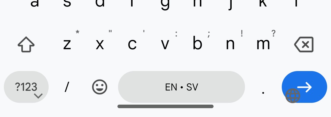

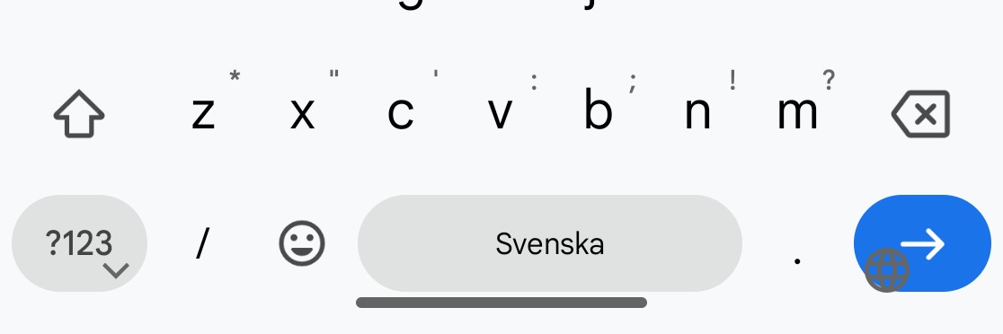

Hey anybody else have 2 extra buttons overlapping the keyboard. It makes using it almost impossible. The number and enter. This is after the update.

should be fixed with reboot, if not, try to “force stop the gboard app and clear the cache”
kudos @kwasow

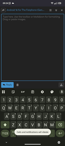

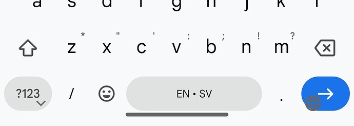

I installed the thing and now my keyboard is screwed up. The down arrow for hiding the keyboard and the globe for changing keyboard layout is placed on top of the ?123 and “return” button, making it hard to type reliably.
Just a thought. What happens if you clear the cache of the keyboard?
See the thread here: Keyboard extra buttons
Thanks! That reboot fixed it for me :rofl:

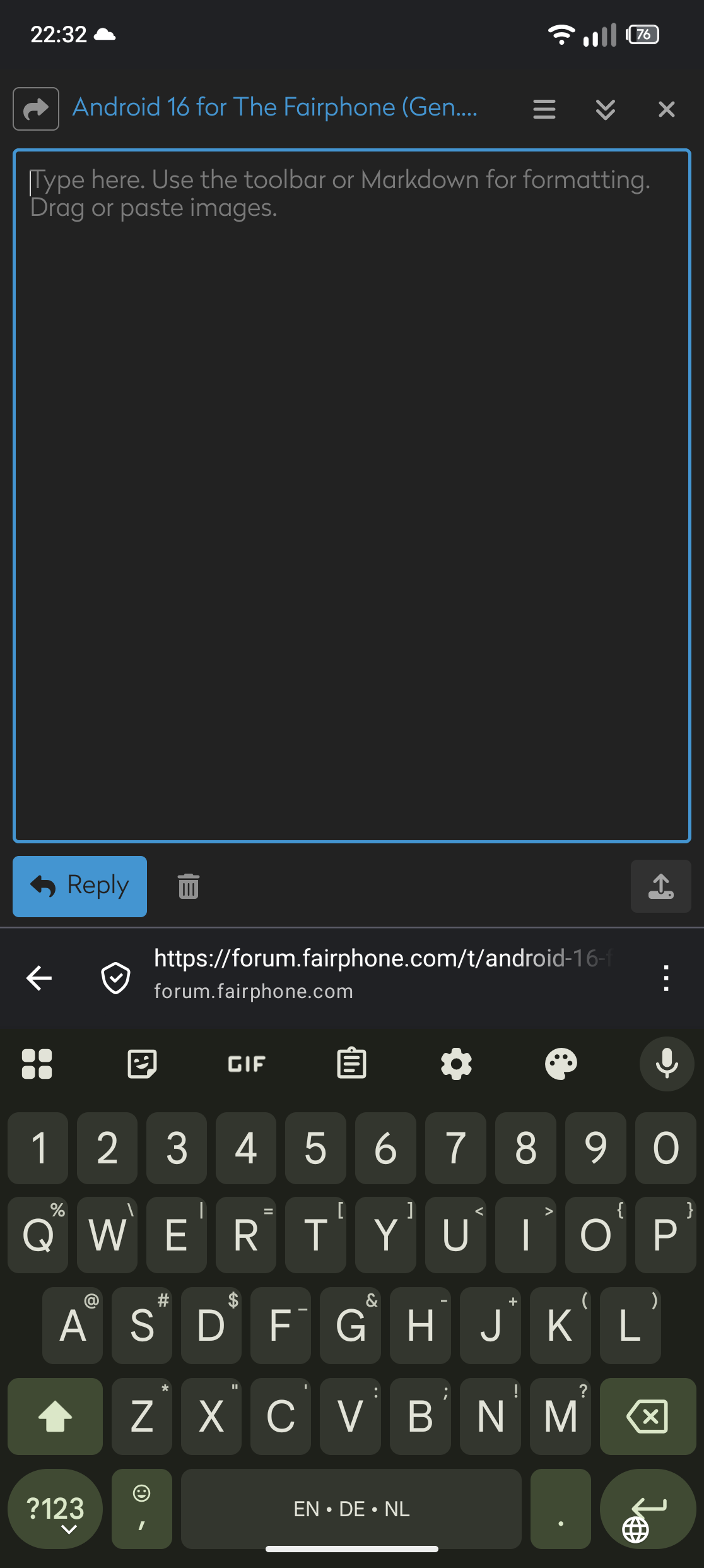

Aside from the issues already mentioned, my keyboard sits too low on the screen. It is tucked behind the navigation bar. ( this happens on all types of navigation bar). I am just using the default Google Keyboard.

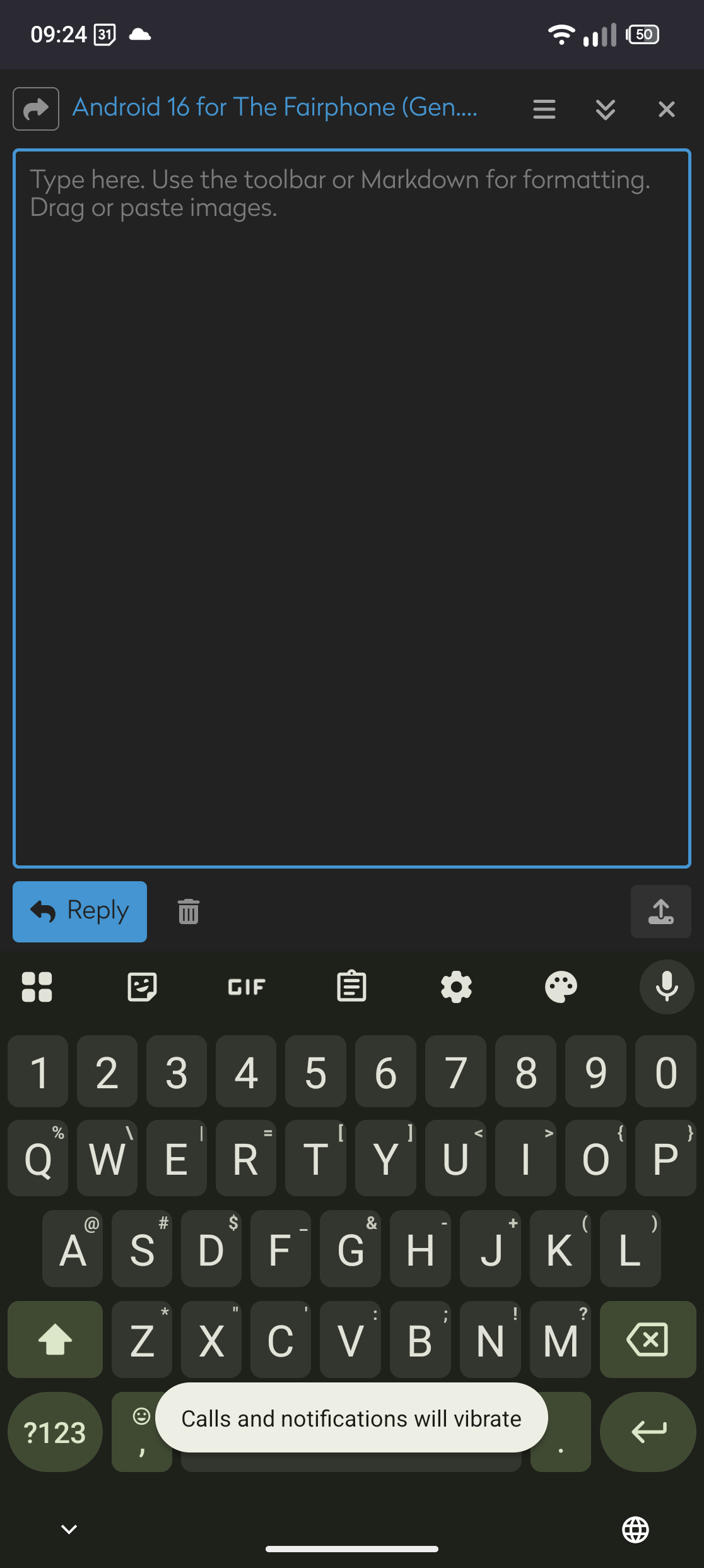

When the keyboard appears, it is partially hidden behind the navigation bar (home/back buttons). Because of this, I can’t access the space bar or the bottom row of the keyboard properly.
This makes typing very difficult or sometimes impossible.
Has anyone else experienced this issue?
Is there a known fix or workaround?
Thanks in advance for your help.
A couple of posts further up this was suggested and confirmed by other users.

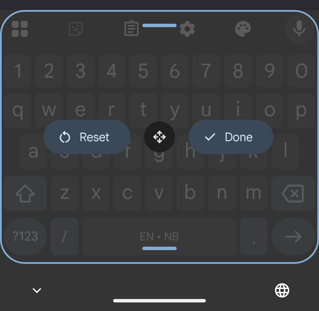

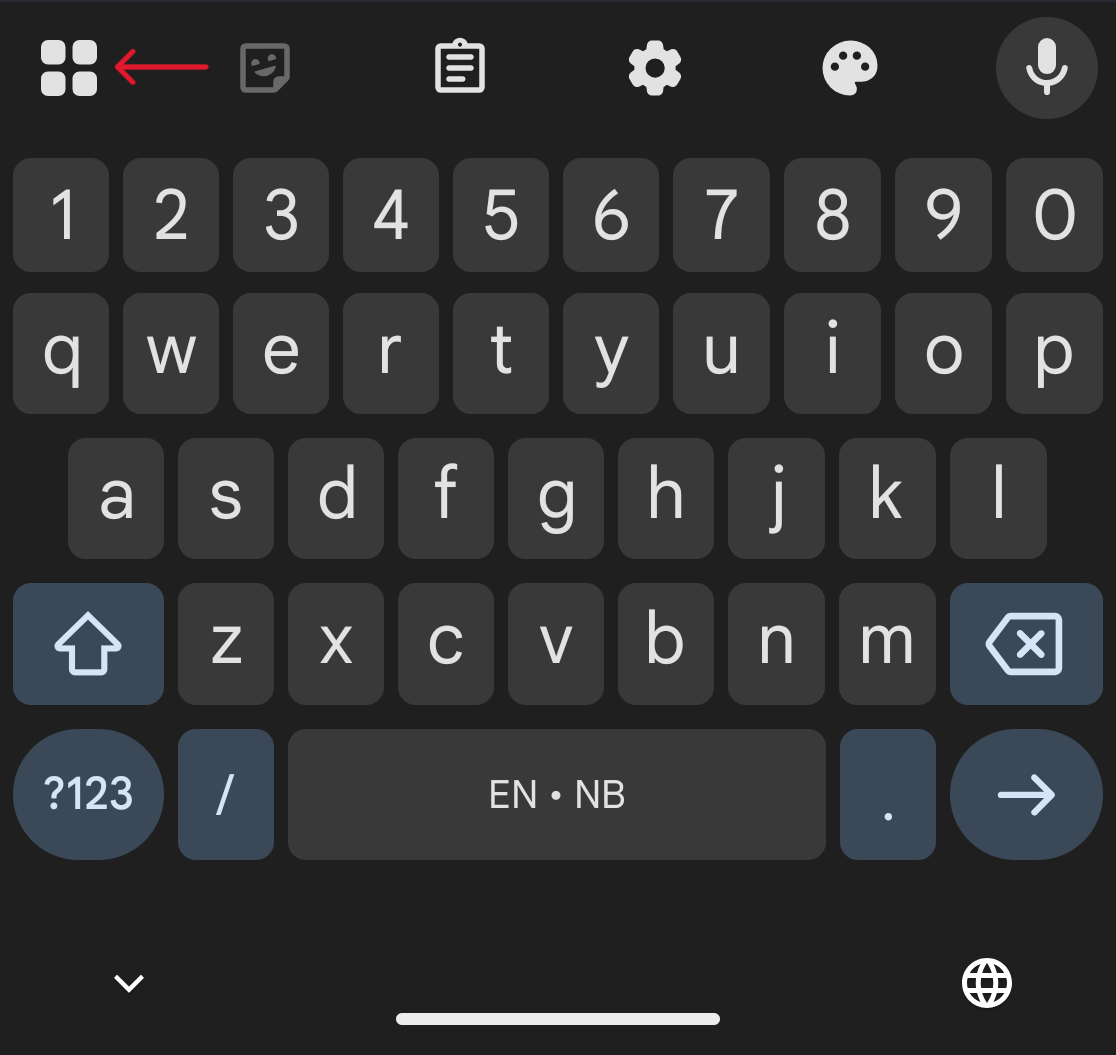

For those who still have the keyboard behind the bottom navigation bar, you can move the keyboard manually. Here is how.
  1. On the keyboard, press the four squares in the top left corner:
  1. Press the “Resize” option.
  1. Move the keyboard to where you want it, and press done.
This worked for me. Hope this helps.

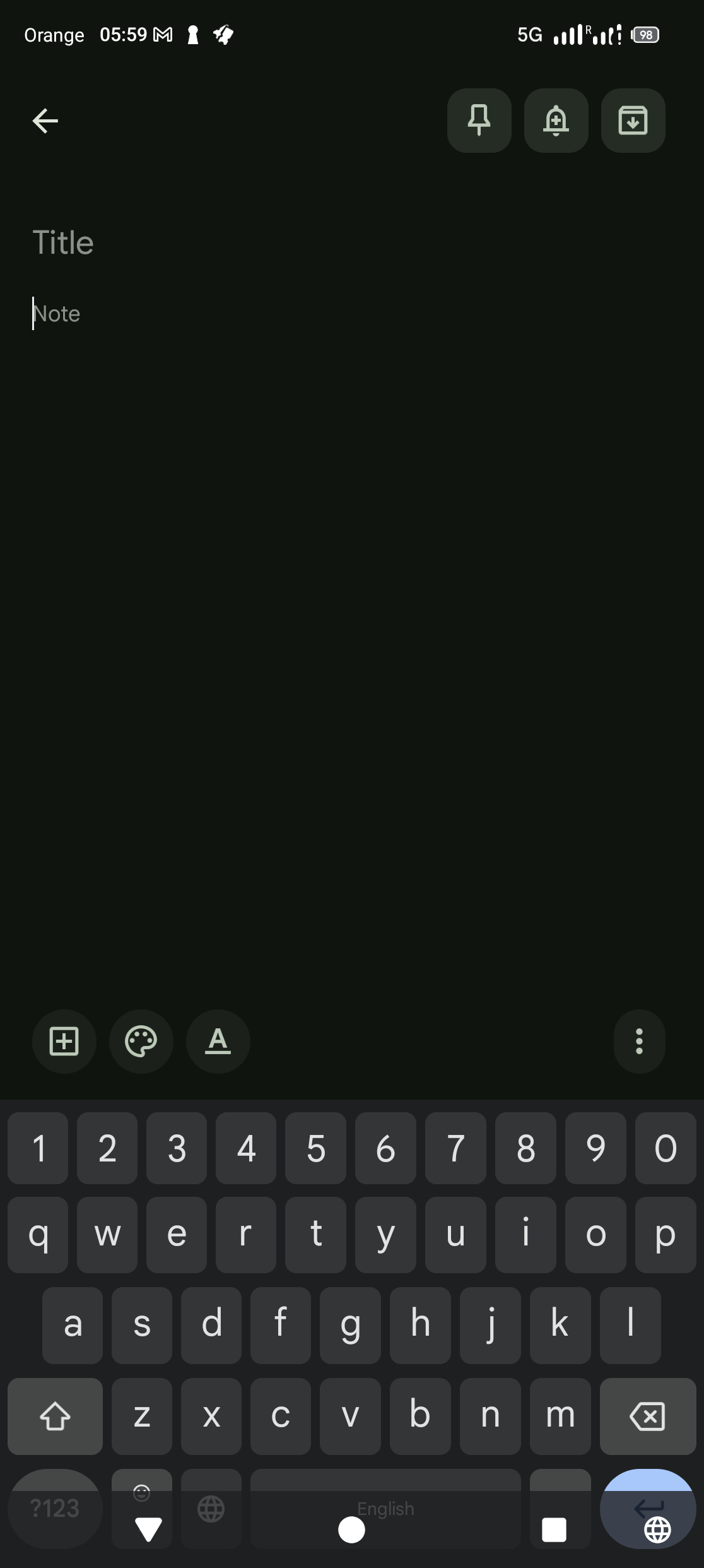

Hi. After latest update navigation bar is blocking keyboard in all apps. See the screenshots. Please issue a hotfix asap. Not cool.
Hi, welcome to the forum. Does restarting your phone fix the issue?
We are users like you, we can’t fix anything and for sure not ‚asap‘.
If a restart doesn’t fix it, can you try gesture navigation as a temporarily remedy?
