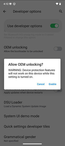

I bought my FP6 with e/OS pre-installed and want to switch to Android. I followed the guide, but when unlocking the OEM Enable option, I dont get asked for a code. I checked my internet (wifi) connection and system version/updates multiple times, but there’s just nothing where I cut input that code.
I can enable the option without the code, but as I understood the guide this will cause issues later on - once I am in fastboot mode and type in fastboot flashing unlock nothing happens on the phone.
thats normal in my eyes as e/OS is installed.

thats written to unlok when the Fairphone OS is installed, you have e/OS installed so you will not get a code to my knowledge. So when OEM unlock can be enabled without code thats fine, there are no different states of enabled.
