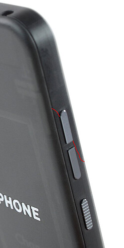

when going to bed yesterday I might have accidentally killed my FP3. It fell off the bed and must have landed at a really unfortunate angle. I didn’t notice it at first, but when it was off and I couldn’t turn it back on I noticed there is a crack going through the frame from the Volume-up button all the way to the bottom screw in the top right, through the metaly-ish bit (assuming some PCB-part? IDK).
Tried to draw it on the iFixit teardown photos for reference:
I don’t know what exactly this is but today I managed to turn it back on, and I noticed the screen flickering, so it seems to me it might part of the connection for the screen?
I’m able to use it when the back-cover is off, but earlier when I put it back on I couldn’t turn it on anymore, maybe it’s putting pressure in the wrong place or something, I don’t know :confused:
Unfortunately the frame is one of the parts that can’t be bought in the Spare Parts store (which seems odd to me given that the frame is supposed to absorb impacts…), so I’m not sure what to do about this…
Any advise on this? :frowning: I really don’t wanna have to buy a new one because everything else still works like the day I got it (except for a battery replacement earlier this year).

Another related question while I’m here. As drawn on the images, the crack also goes through the frame around the buttons. Is that part of the rear module or otherwise replaceable as well?
The buttons are in the rear module. People here reported having been able to transplant them, but frankly I don’t really see a benefit in this when you can replace the rear module as a whole. Basically the rear module is everything that remains once you have removed the back cover, the battery, the display, the three small modules (top, camera, bottom) and the motherboard.
Thanks, it looked like the frame was a separate part around everything :smile:

OK it’s probably because as the rear module is in plastic, it’s flexible, and now way more flexible because it’s broken.
As a consequence, I’d suggest a rear module replacement indeed.
