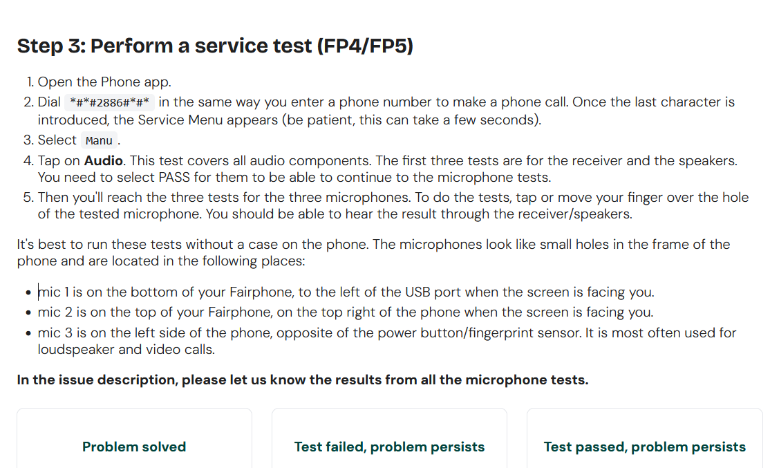

→ I can´t do the “service test” for audio. The device doesn´t react to the figures I have to dial. Maybe because it´s not stock android but calyxOS and needs other “codes”?
–> Can you help me?
Hi,
Yes, You can do the test only with Fairphone os. The test can help you to know if it is a problem with the material or software. Fairephone os use the two microphones, and Calyx only one ( I talk about fairphone 4, i don’t know for the others). Have you test with headphones?

The mics are on the core module. So in case its really a hardware failure only FP could fix this and you would have to move back to FPOS to exclude the OS is somehow interfering. Are you sure you dont cover any mics when its happening? Any chance of dirt in the mic holes? Does it happen with normal calls, and/or on loudspeaker. What about voice messages, WA Calls etc?
