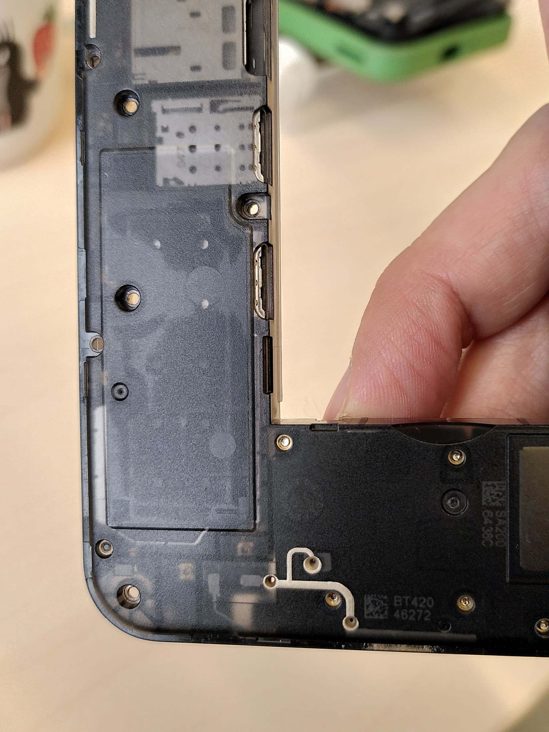

So it finally happened to me - my FP3 got a water damage:
It starts (vibration), but the display remains black. The display works on another FP3. I think I see some moisture inside (picture) - is there a chance to dry this? Should I just wait or is there a way to accelerate it without damaging the phone?
Any help is appreciated!
You need a Torx T5 screwdriver to disassemble the core module – just two of these screws are holding the motherboard.

Dear urs, dear Meaghan,
many thanks for the fast reply! I was looking for other posts regarding this topic, but couldn’t find the guide. Thanks again!
