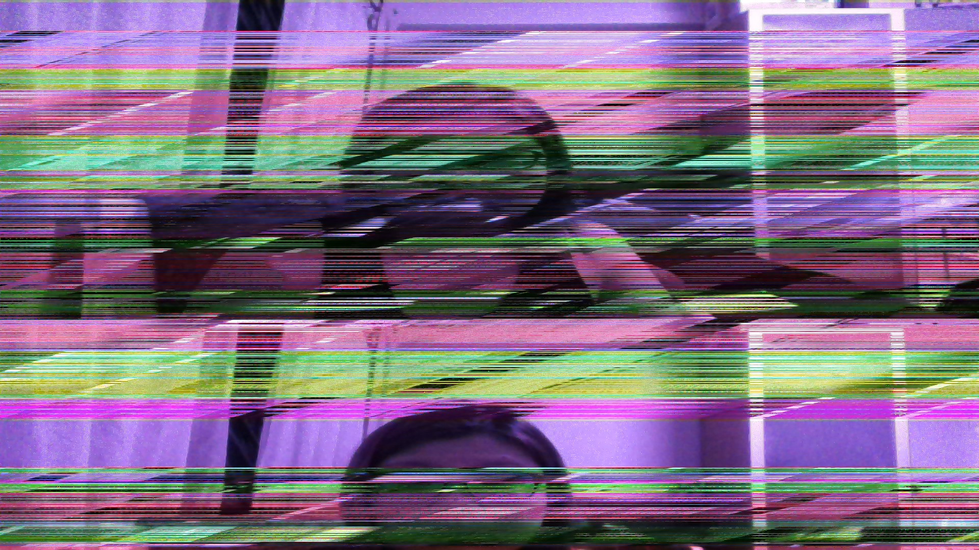

symptoms of the issue
  1. Main (rear) camera preview shows extreme purple-black distortion w. vertical lines (similar to this distortion, on a laptop camera)
