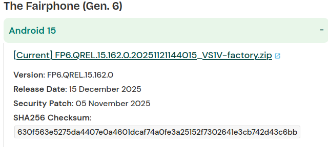

I installed FPOS with bootloader version FP6.QREL.15.162.0.

“bootloader version” is not involved but “Android Security Update” that was registred
at time of the unlock.

Well unfortunately, I didn’t get that number. But my current ASU says “November 5, 2025”, so I guess I’ll wait 6 months before trying to reflash + relock, which I was planning to do anyway.

you should relock with next FairphoneOS release, that should include January 5, 2026 ASU, when current e-3.4 include January 1, 2026
