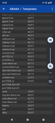

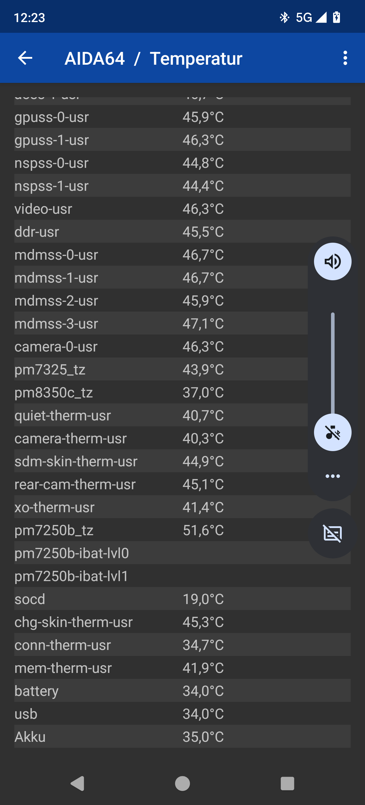

I downloaded Aida 64 to have a look at what the temperature sensors sat.
There are a lot and it seems not all are used. But what is obvious after a few seconds is that 2 sensors are going wild.
pm7250b-ibat-lvl0 and pm7250b-ibat-lvl0.
While everything else is stable there toggle wild between +20 and +75 degrees

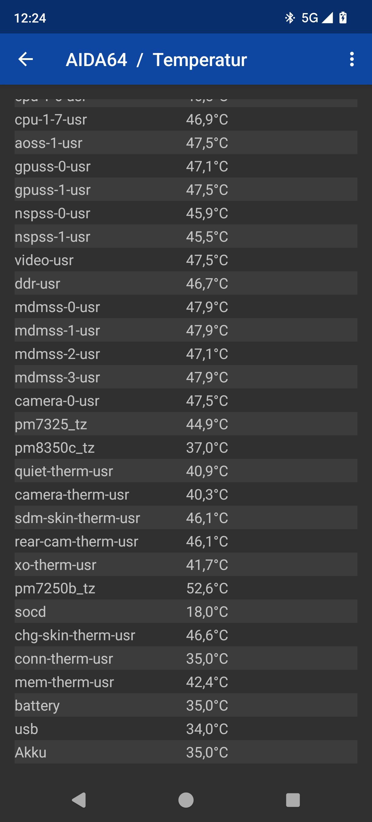

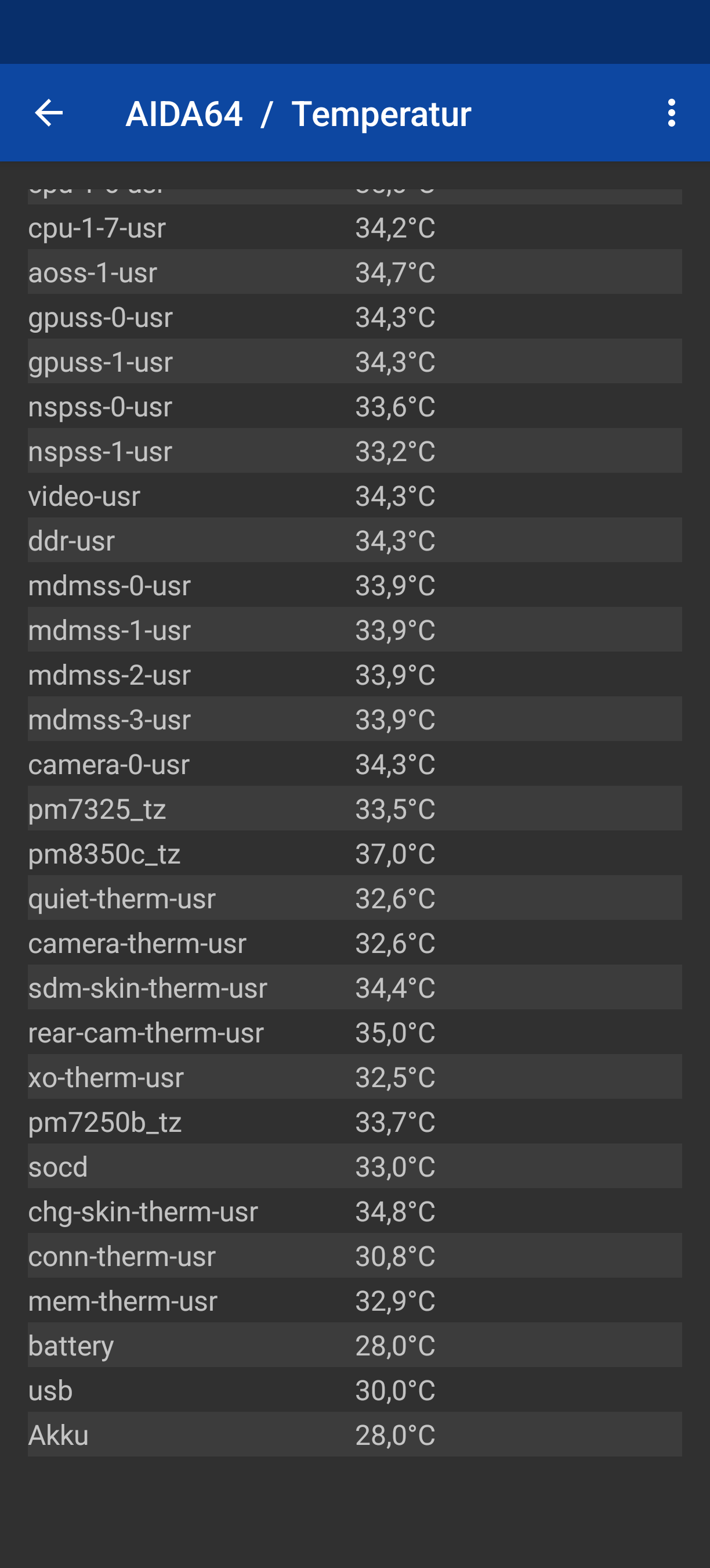

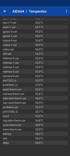

I installed AIDA64 v2.08 on my FP5 and it didn’t show your mentioned sensors, see the attached screenshot.
Only a pm7250b_tz is shown, the values are going from 33-39°C.

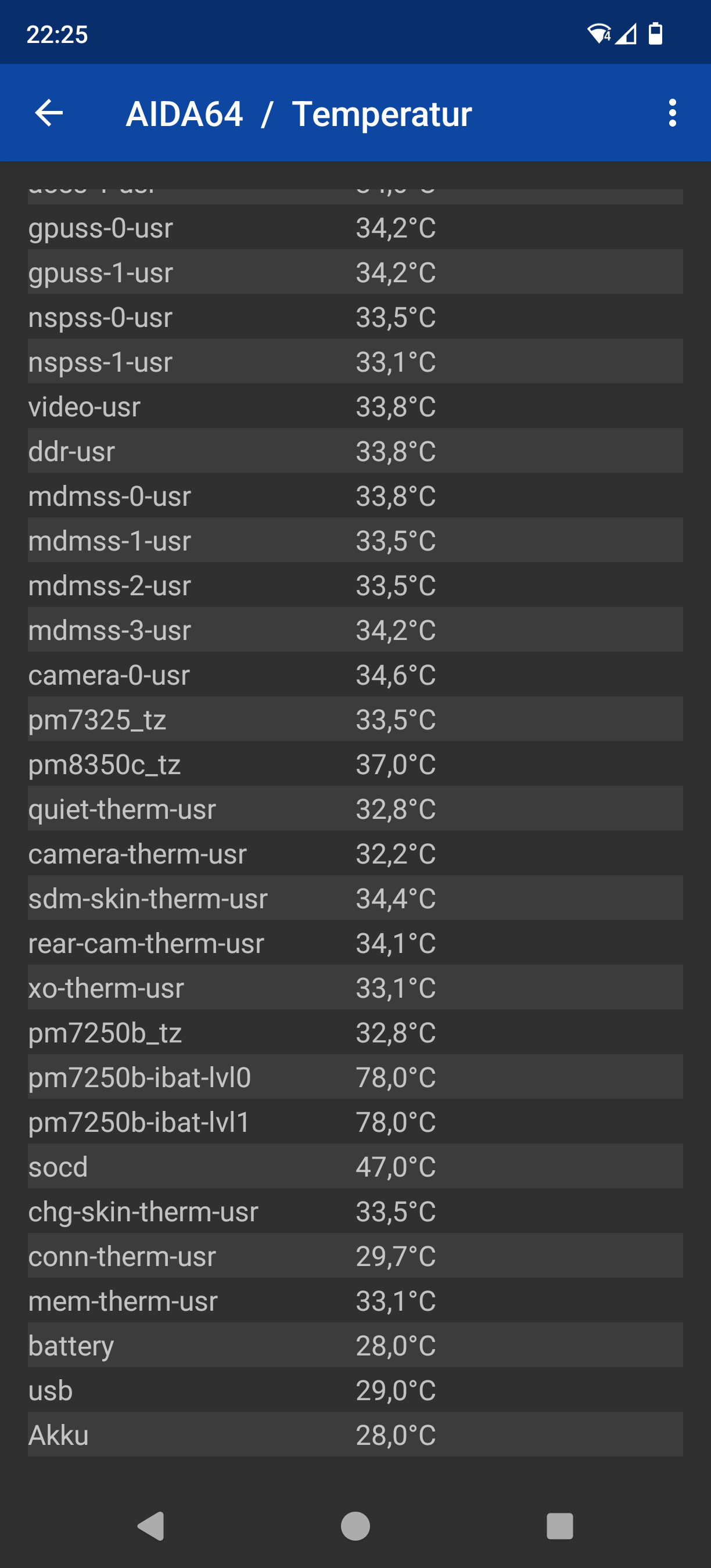

This is how it looks on my phone. So question is why my Aida displays these sensors. And if android is using them or if they are false values.
I caught them when they where at max scale.
My Aida is also 2.08

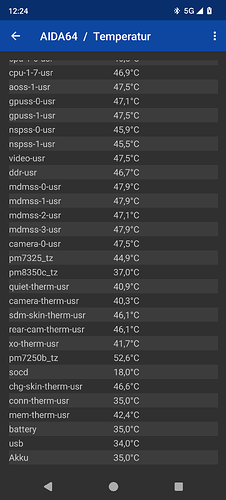

Interesting. If I connect my charger both values disappear from Aida (but only the values) if I restart the entries for those sensors vanish completely and look like the posted ones from the previous poster
I disconnect the charger they reappear.
