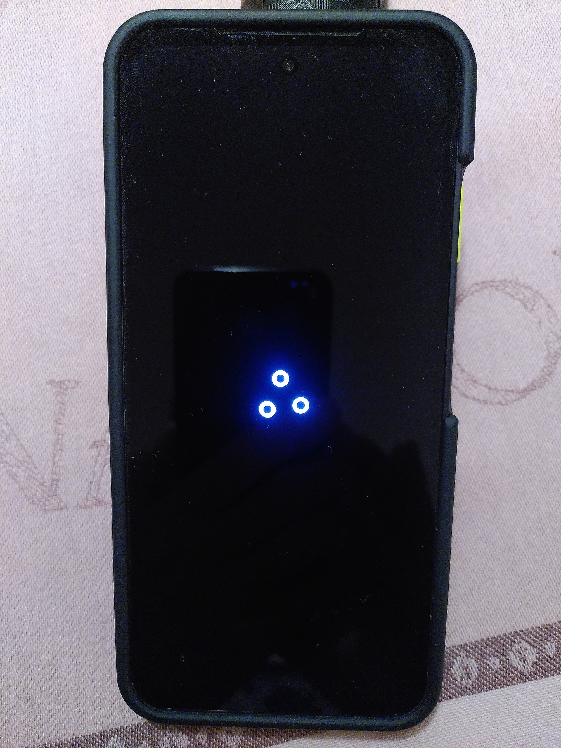

The FP6 is stuck at boot level: the screen displays three spinning circles (as usual, see picture), but nothing else happens, and this can go on for hours :-/
Any idea of how I could fix this?

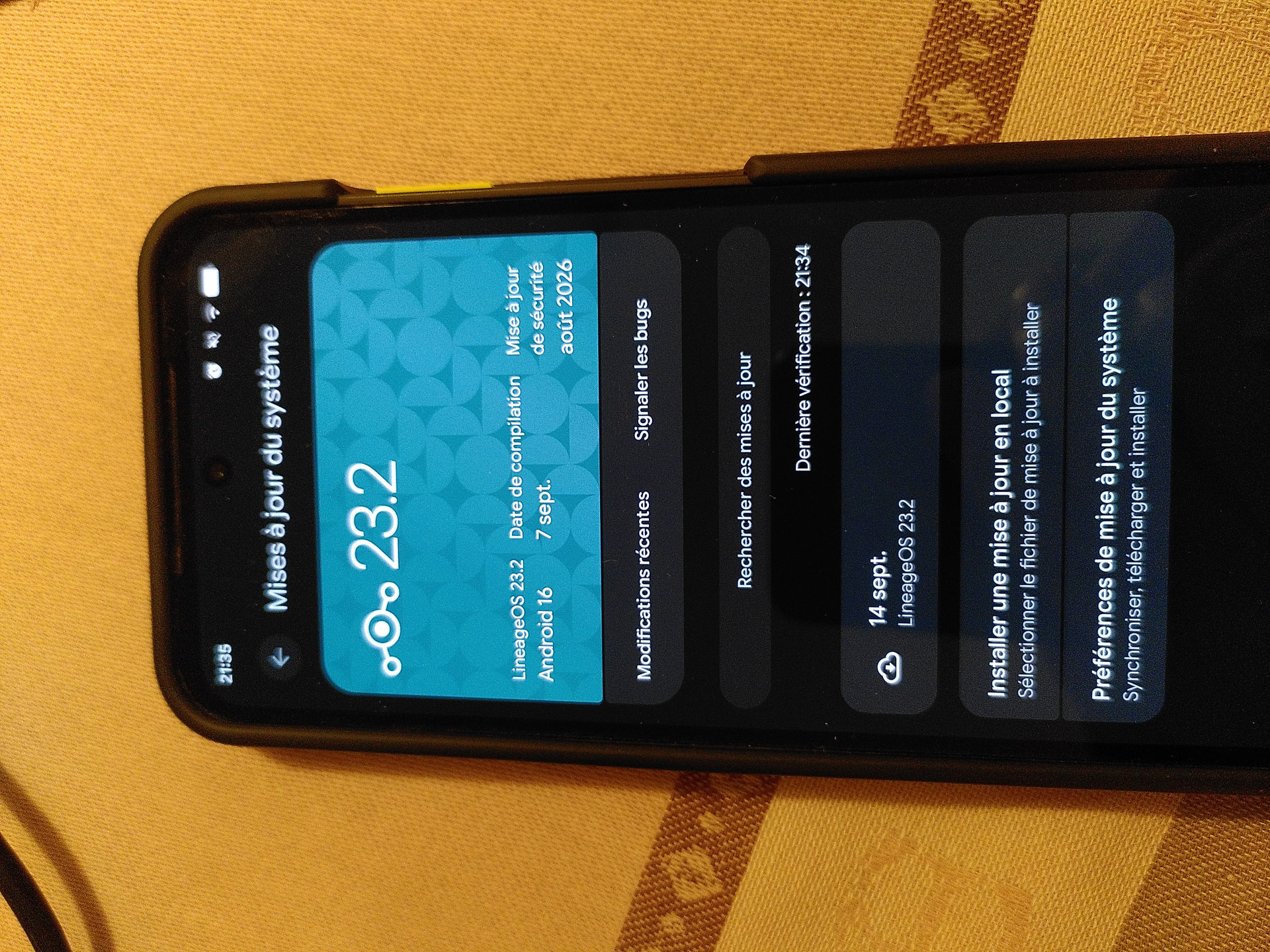

When I held down the power-on button, the three circles changed and the boot process completed normally. Whereas previously, when I did that, the FP6 would reboot (I give you my word, please believe me I did it around 10 times today).
Below is a screenshot showing the system version after this successful boot)
If its the previous version, due to the repeated boot attempts the system Fell back to the other slot and previous system thats intended when things go wrong

Looks like you managed to switch the active slot
