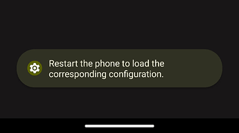

FP6 Restart the phone to load the corresponding configuration - 15.148.0
After the update, my FP6 restarted itself after displaying “Restart the phone to load the corresponding configuration.” message. It has restarted every subsequent start the same way. About 5-6 times so far. Any idea what this is?

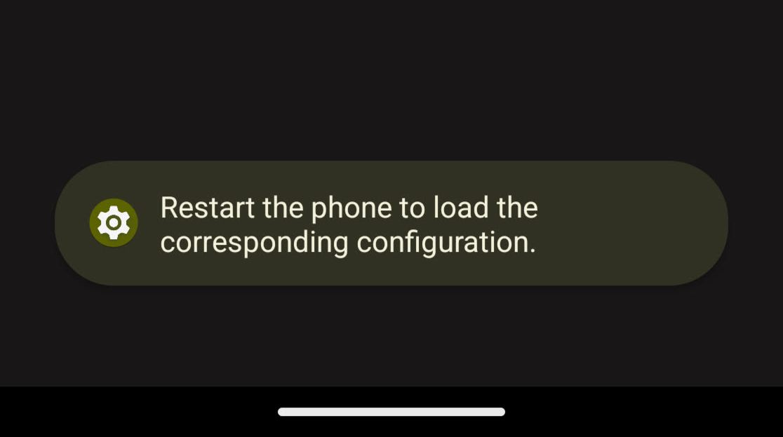

I just updated to this release and my phone keeps rebooting randomly. The screen just says “Restarting”, and then it does exactly that.
It says something really quickly about applying a configuration that requires a restart so there’s “something” that seems to change a config and then triggers a reboot.
