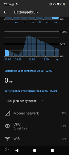

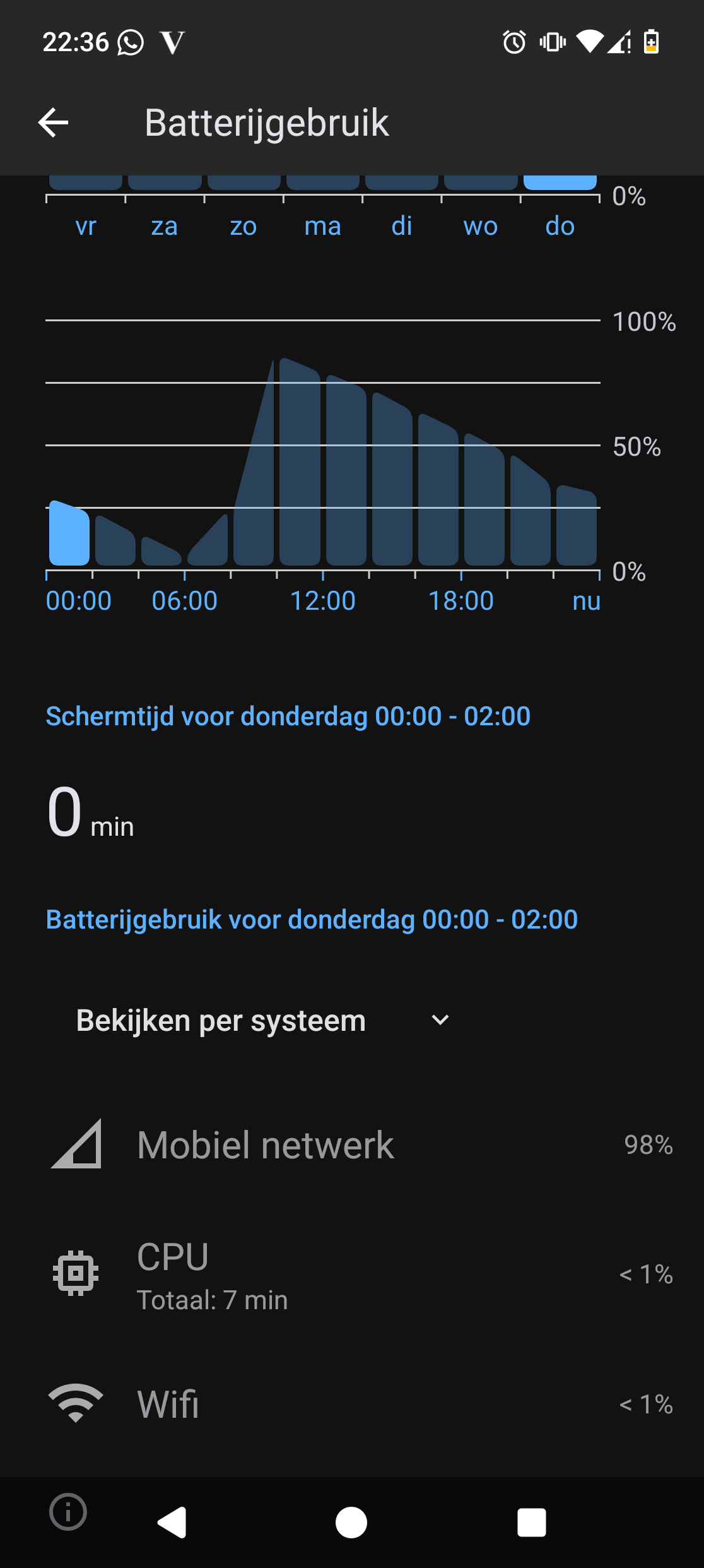

Since I got my Phairphone 6 the battery is draining faster than expected. This has been going on since september, but this week the battery was functioning normally for a couple of days without me doing something different.
Most of the time my battery won’t last for more than a day, even when I don’t use it that much. It is especially weird that it drains 20-40% each night while I don’t use my phone and it is in battery saving mode. Looking at the battery use I think there is a problem with the mobile network/mobile data, because it uses A LOT of battery even when I turned the mobile data off.

Screenshot below from a timeframe at night when mobile data was turned off.

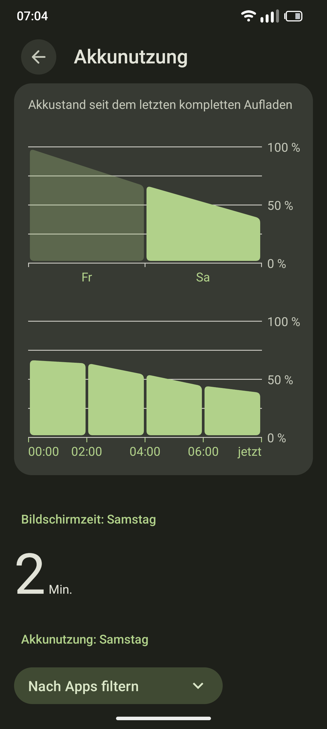

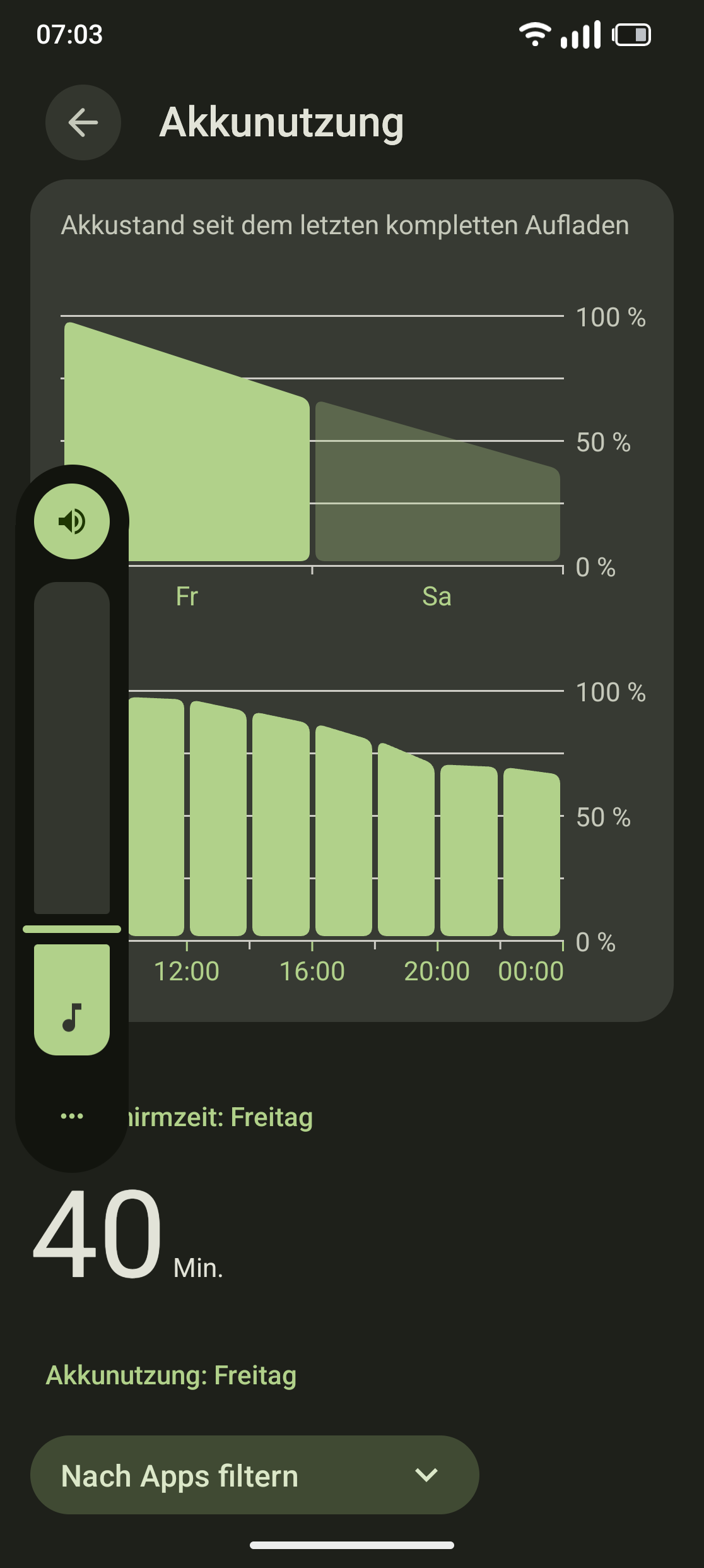

It doesn’t matter which ROM I’m using. Stock OS, iode OS, eOS. All with the same behavior during night time. All apps are <1% usage. Therefore I’m really confident it’s not because of a certain app. Mobile Network is at around 95-99% of system usage.

Today I set up the preferred network to 4G and turned “automatically select network” off. The battery drained less then in a normal day, but still the mobile network used 86% of the battery since midnight. It is about 90% when the mobile network is turned on and about 50-60% when turned off.

Same problem here. FP6 with e/OS since august. I could go a whole week without charging the phone with 5G on. Last week I updated to the recent OS version and now my battery is drained after 4 days. I think this is indeed a problem with e/OS. Hope they solve it soon.
I tested a little bit more and at least in my case the issue appears to be the combination of 5G and the O2 Germany network.
5G with Telekom no issues. Couldn’t test Vodafone.

I’ve also noticed worse battery life on A16, attributed to mobile network in the battery manager.
I’ve also noticed 5G in more places, so maybe they’ve added new frequencies or changed the threshold to switch to 4G?
