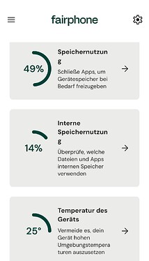

Hey, the temperature is displayed dynamicly in the My Fairphone app under “Phone → Device Status”.
Here in german:

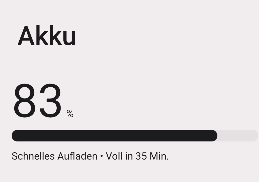

I alway use a 18W charger with USB Power Delivery function. It fits eco and fast charging.

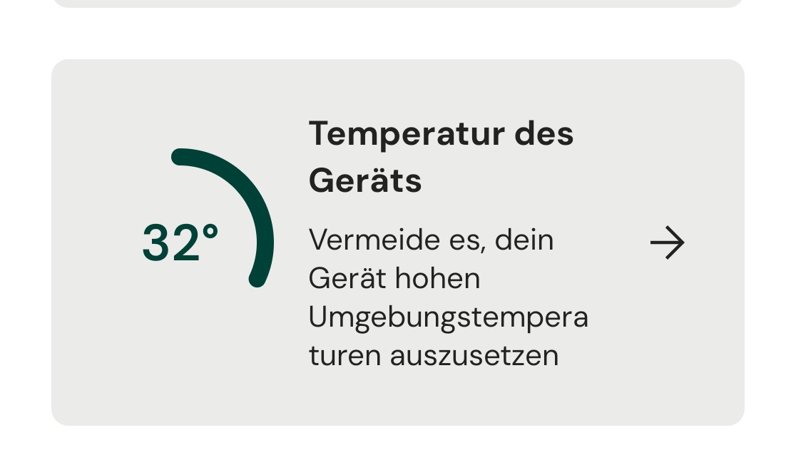

The temperature rises steadily from the displayed 25 degrees (which is also the ambient temperature) to max 32 degrees during fast charging:
It is likely intended to measure the ambient temperature, but since it is installed inside the device, the device’s temperature will presumably affect it.
