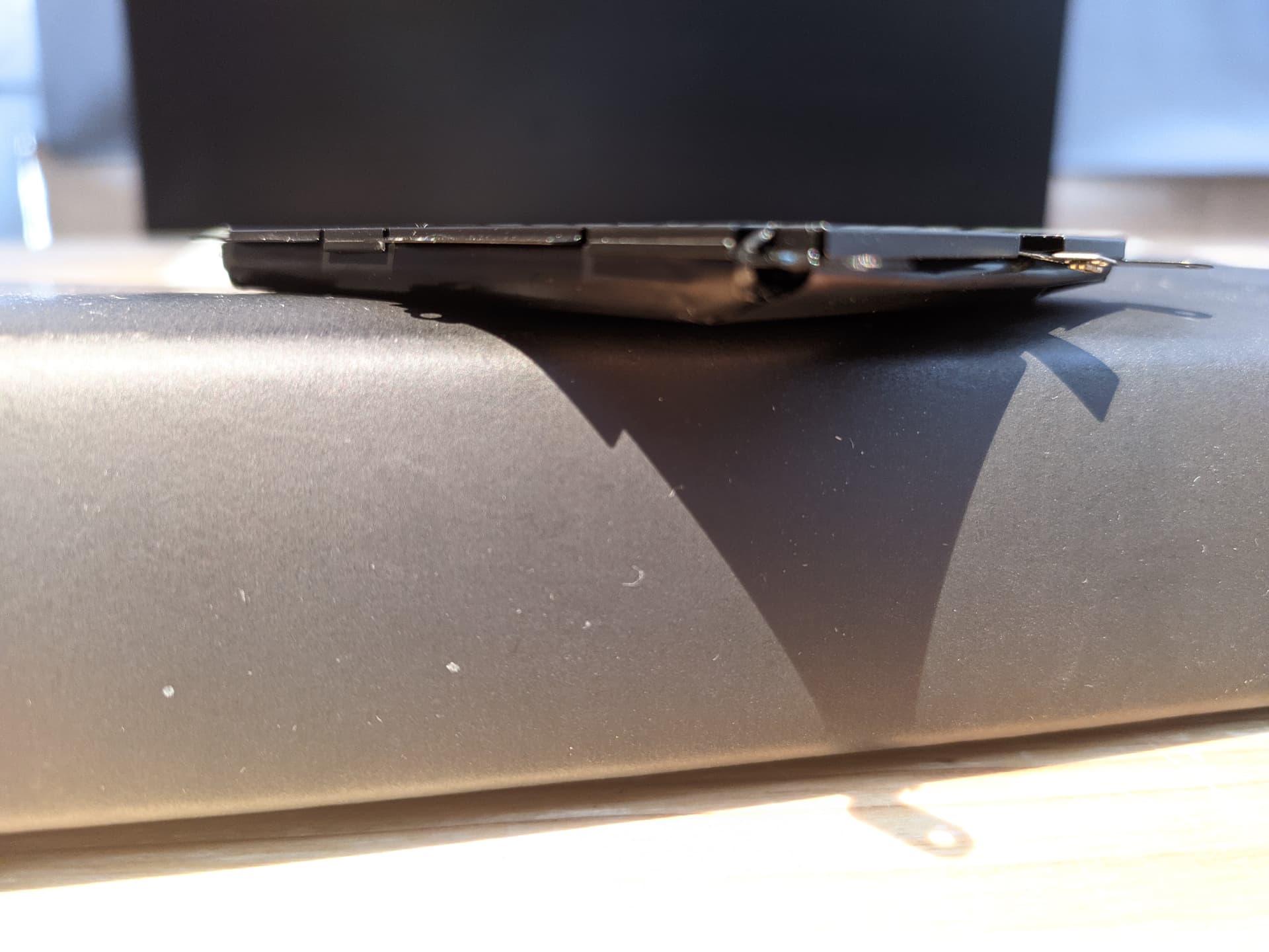

What I was told at the Launch event by Fairphone was that based on “customer data”, customers found the recent Fairphone models bulky and heavy. So one of Fairphone’s targets in designing the FP6 was to make it smaller, flatter, lighter. This has been achieved (see Fairphone dimensions and weights). However, this resulted in the need for battery screws. Perhaps a closer look at the battery helps to explain this.
The photos aren’t perfect, but what you can probably spot is that the downside of the battery (visibile in photos 2 and 3, silver grey label) and the upside (all black and with lime colour fairphone logo, not fully visible in the photos) are not symmetrical. And the upside is enforced with a hard plate that almost feels like metal. The downside is not hard-cased (to allow for an overall flatter device).
Now the screws serve to ensure that the battery sits tight and does not move.
