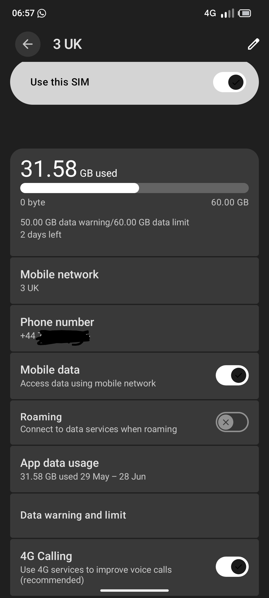

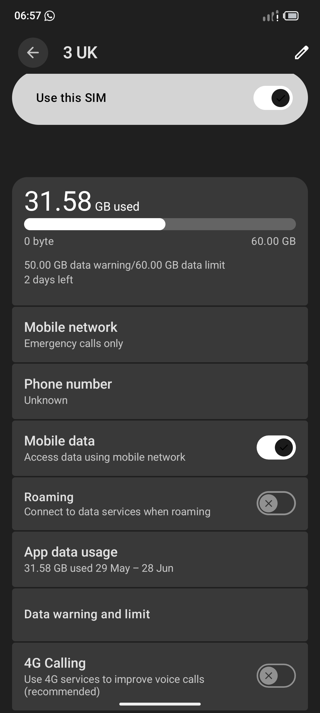

Since the update at the start of last week (June 22nd) every 5 to 6 hours my phone disconnects from the mobile provider (Three UK). This means that I cannot send or receive calls. Resetting this is easy as I just turn airplane mode on for a second and then back off. Okay for daytime not so good at night. Phone works fine between the resets until it happens again. Only has happened since update.
Wondered if anyone had any ideas.

Could you tell us your network settings, in particular 3G/4G/5G and/or 4G calling?
Hello,
4G calling is set to on and preferred network type is set to 5G/4G/3G/2G.
I am not sure what other information you need.

I have been experiencing similar issues over the past few weeks (like you, I believed it coincided with an update). I have no idea when the network is dropping, but occasionally when I do check the phone it’ll have no network. I have noticed that when it dropped if I left it, it would eventually recover the network. I had been rebooting it until now when I have observed it lacking a connection, but I have tried out the flight mode method here and that also works.
