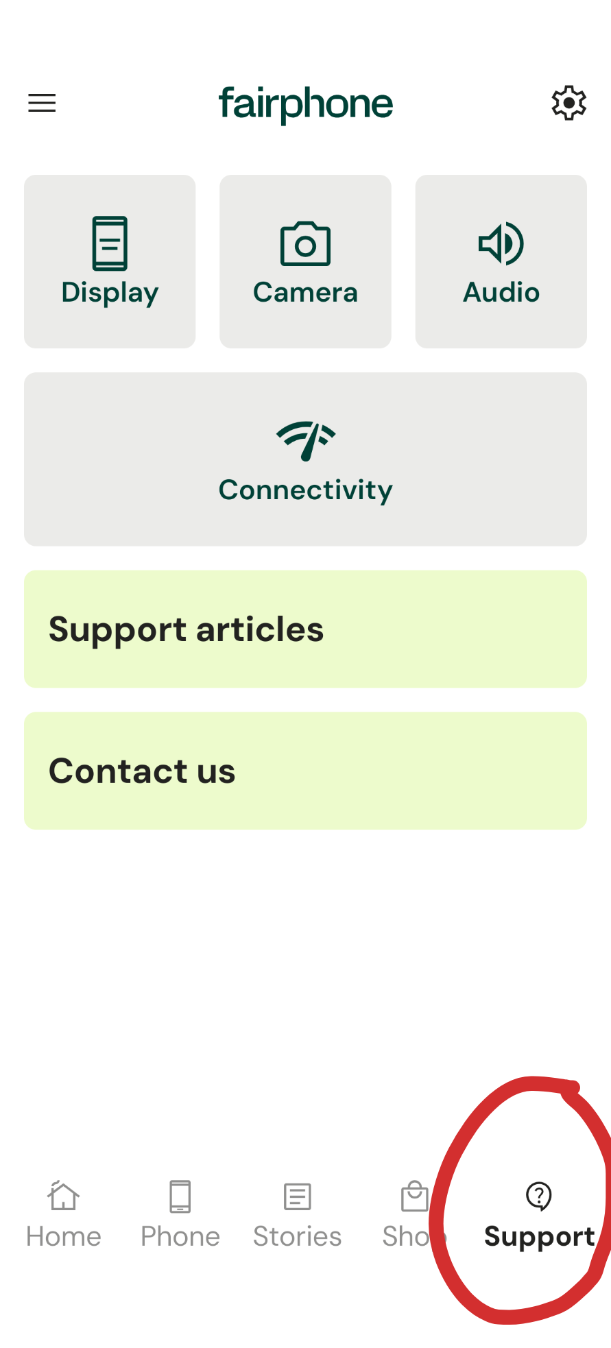

Hi Meaghan
Where can I find this camera test in the My Fairphone App? Thanks.
Here it goes

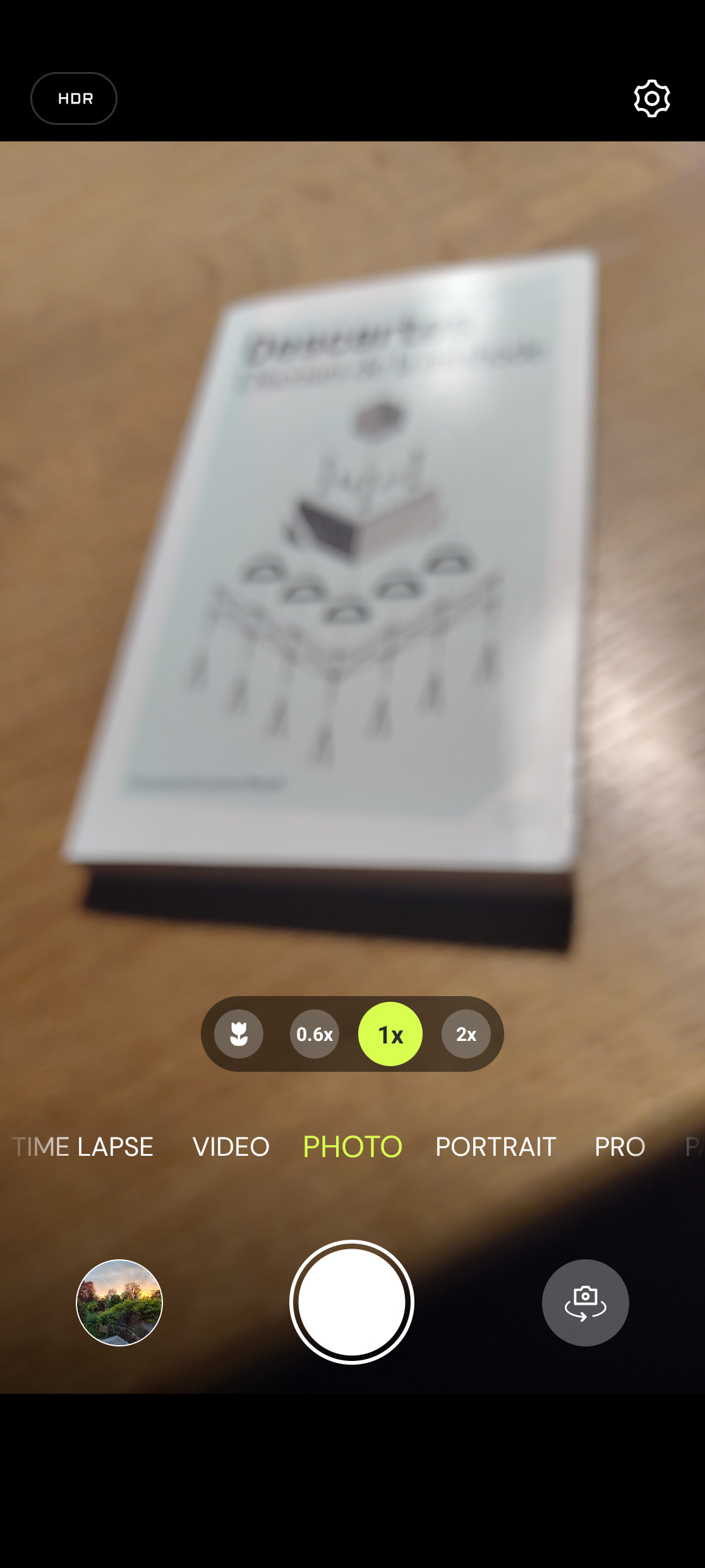

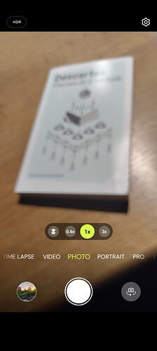

same problem for my fairphone6, this is my initial post here:
and I’ll reply here:
After doing some research, yes the main module camera seems to be broken because when in put my finger over the main camera lens and the wide lens for detect the correct lens, the wide lens take correct pictures (for the macro mode too) and classic photo mode is full blurry.I ‘ll contact the shop for support.
