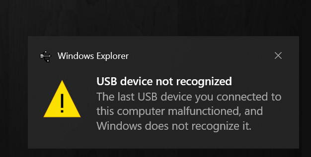

Installed FP5.UT2P. B.122.20250422 on my FP5 without issues, then immediately after noticed that I can’t connect the phone to my computer for data transfer via USB. I use this often, and have used it shortly before doing the update.
Double-checked cables and computers, and have isolated that the issue must be with the phone.
I can charge the phone, but cannot connect to any computers for data transfers.
Tried now to do a factory reset of the phone as to eliminate any setting/apps conflict, but with no positive result.
Cannot connect means you cant change from charging to data transfer or what does it mean exactly?
I get this meassege from WIN10 when I connect the phone. Same with other computers using different cables…
The option for “charging to data transfer” is greyed out and cannot be selected.
I can try to select the [USB controlled by → Connected Device] but it failes with “couldnt switch”.
