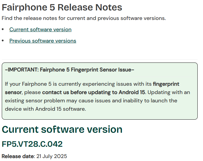

There’s a notice on the Release Notes page now, warning about updating if you have a broken finger print sensor:
-IMPORTANT: Fairphone 5 Fingerprint Sensor Issue-
If your Fairphone 5 is currently experiencing issues with its fingerprint sensor, please contact us before updating to Android 15. Updating with an existing sensor problem may cause issues and inability to launch the device with Android 15 software.
Screenshot of it, in case it will disappear again
Not really specific and pointing out that the device will be lost (requiring send-in and reset) afterwards…
Also, no details on how to contact. And not about waiting times to get a response.
I don’t think many people would have a look there before doing the update. I wonder if it shows on the phone as well?
Pretty impressive that they didn’t learn from the Fingerprint issues with the FP3 that they have to be clear about stuff like this. Or, I dunno, cancel the update entirely until this has been patched. Until that happens people are going to keep coming in here with broken devices.
