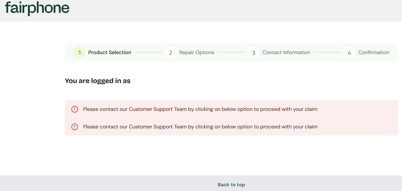

I went further and tried to open a request but i got stuck here several time from browser (firefox, then i tried chrome with the same result), then i tried from the phone app i got stuck even before that point, at the selecting device page (there seems to be an overlay that i don’t seem able to remove from within the app that block me from going further).
I guess i have to send a normal email after all, probably the form should be design better.
