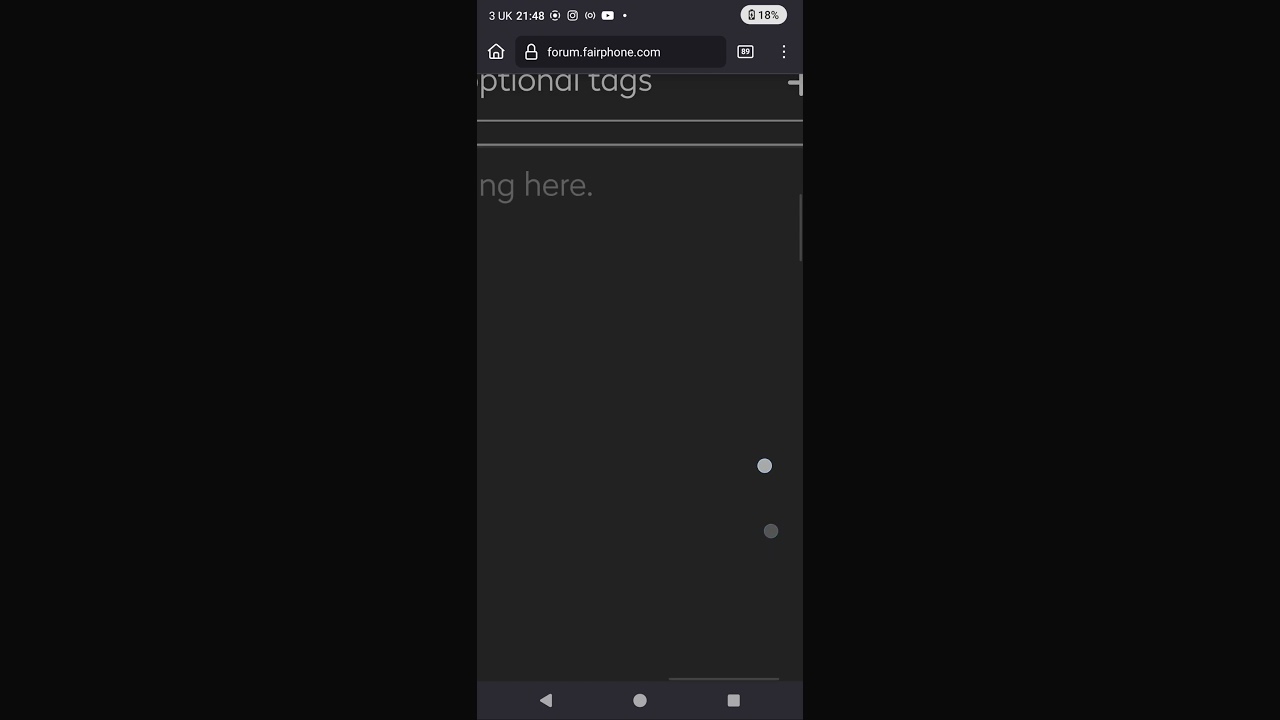

FP5 display continually loses touch input when device is charging
You can see an example in the undermentioned – at first, I demonstrate it unplugged, then plugged, the unplugged again. The difference should be evidently shark:
I post this here to acquire corroborations. Does anyone notice this occurring on their device? Considering that my fp4 used to ghost too, before the firmware update remediated that, I shan’t be surprised.

Ah, damn. Perhaps it’s because my charger might be ungrounded:
@yvmuell, it is occasionally less responsive, in that inputs don’t go through. However, more so, it merely loses input almost immediately. Thanks though.

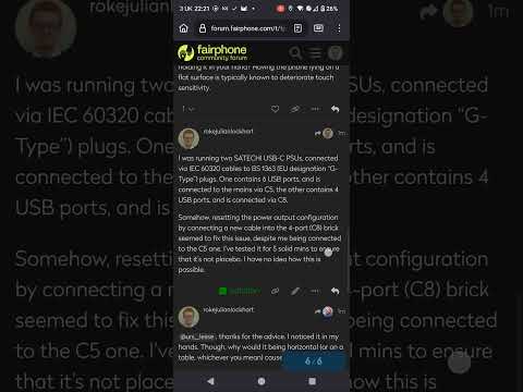

Are you noticing a difference – while charging – between having the FP5 lie flat (e.g. on a desk) and holding it in your hand? Having the phone lying on a flat surface is typically known to deteriorate touch sensitivity.
I was running two SATECHI USB-C PSUs, connected via IEC 60320 cables to BS 1363 (EU designation “G-Type”) plugs. One contains 6 USB ports, and is connected to the mains via C5, the other contains 4 USB ports, and is connected via C8.
Somehow, resetting the power output configuration by connecting a new cable into the 4-port (C8) brick seemed to fix this issue, despite me being connected to the C5 one. I’ve tested it for 5 solid mins to ensure that it’s not placebo, but you can see for yourselves:
I have no idea how this is possible.
@urs_lesse, thanks for the advice. I noticed it in my hands. Though, why would it being horizontal (or on a table, whichever you mean) cause that?

I believe that this must be the cause, for as suddenly as it appeared, it disappeared. The reconfiguration earlier appearing to remediate it was a coincidence.
Fascinating. I’ve never managed to screen record it happening so clearly.
But I’m still strongly convinced that this is a software issue, not a hardware one.
As I’ve previously encountered a bug, where the phone keeps showing it’s charging, while it’s actually not plugged in.
And I spotted that behaviour because I noticed those same touch inconsistencies like if I was charging.
So it can’t be any sort of grounding. It happened even when away from the wall.

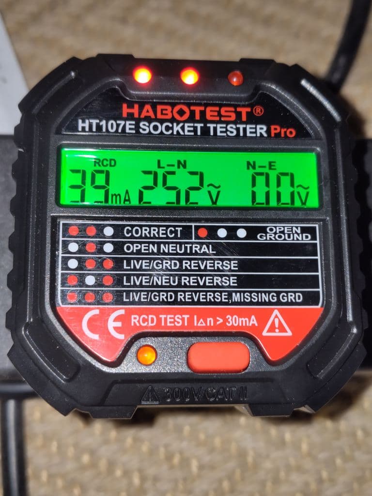

Thus far, I’ve seen deviations from ≈ 245 to 252V:
[1]
…which is the upper bounds of expected (<253V). [2] It reproduces at both, and never when not charging.

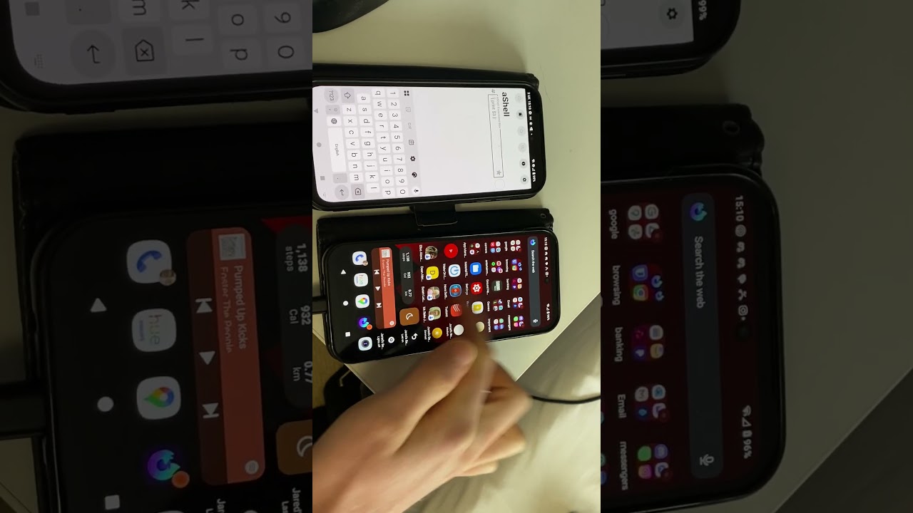

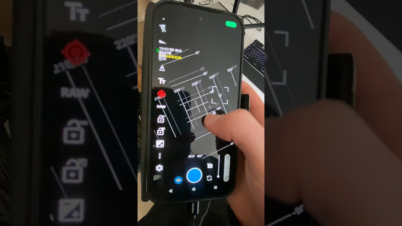

I can reproduce on my brother’s fp5, too:
It took me a moment to realise that it reproduces better when I move slower, and I apologise for the vertical upload orientation. Blame iPhoneOS.
This so perfectly shows the experience I’m having. But for me it’s maybe less egregious. It only happens with some touches, and I’m gaslit into thinking I’m just touching my phone wrong.
@Nabalazs, I’ve reason to believe that it might be due to my charger, since although it reproduces on my brother’s device when it’s connected to my charger during the random periods when this applies, it doesn’t ever appear to occur when connected to his.
Consequently, are you able to test whether it reproduces on another of yours? A different model, ideally. Additionally, does it solely occur at random times of day for you, too?

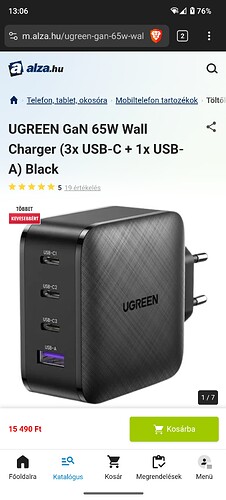

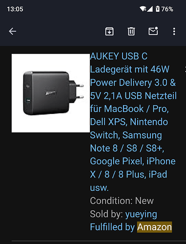

Now that you bring this up, it happens way more when I use an older charger with an A-C cable. (The C port on this charger was always acting weird, that’s why I only ever use it’s A port)
And happens waaaay less, or almost never when I use a fast charger with a C-C cable. I always plug into port 1.
As of random time of day… Not really? Happens any time I plug in, as far as I can tell. But I never really paid attention to it, to be honest.
