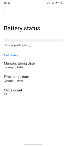

I have an FP5 running /e/OS 3.3 (Android 15).
I recently checked my battery status (System / Device diagnostics / Component health / Battery status) and was presented with the following screen.
The charging and battery life in my phone has been a pain since ever. I’m wondering if this has anything to do with it.
Anyone has a similar experience? Does this mean that there’s something wrong with the battery? Or is this a software issue?
I’m carrying the original battery, about 2 years old now.
it is the native unix date
Yep, that’s the UNIX Epoch. World class programming, Fairphone.

same anomalies : unix date, and ‘0% of original capacity’ while the battery seems ok. then, anything wrong with the battery capacity though?

Well.. I have to charge my phone 3 times to make it through the day. Quite often when charging the phone shuts down. Sometimes I leave it on charge overnight but the battery never reaches 100%. Overall, the charging experience has been challenging, to say the least.

I’ve tried with various chargers. I have the less issues when I’m using Fairphone’s charger and cable. However this is not always possible and I need to use other charging devices. But even with the “original” charger I have issues, such as phone not charging over a percentage (e.g. 88%, and, no, I have not set an upper limit to charging) or charging very slowly.
Regarding the 20-80% rule that you’re suggesting I’m afraid it doesn’t work for me. I need to charge three times a day to keep my phone running!
