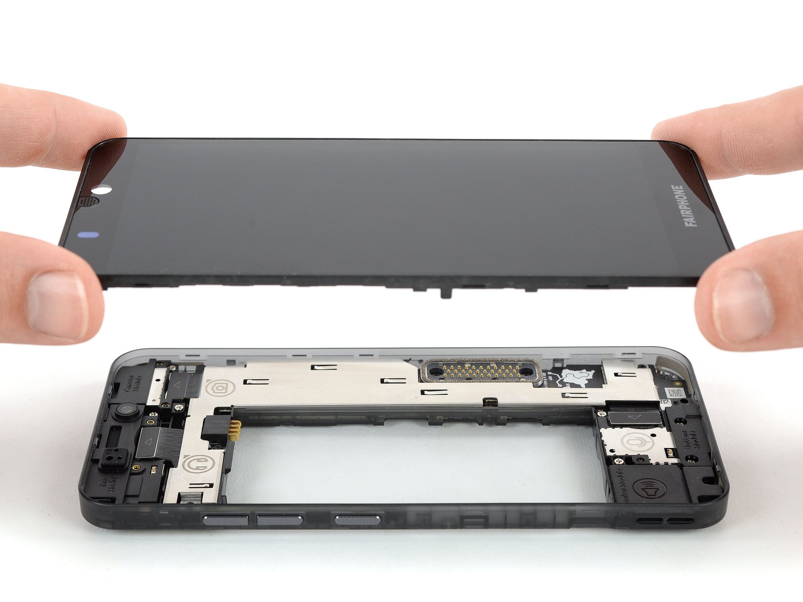

Take a look at this picture (it can not be uploaded) from step 9 of the iFixIT tutorial:
https://d3nevzfk7ii3be.cloudfront.net/igi/gKiTEgs2q4qGXYPA.huge
When looking at the phone, you can see small tongue-like contacts.
On my phone I had the impression, that one or two were not sticking out like the others.
Therefore I took a pointy and slim knive and just inserted it under the tip of the contact-tongues. I did not exactly try to bend them upward, just pushing something slim under the tip.
And since then - for a few weeks already - everything is just perfect and back to normal again.
I can’t tell, if it was cleaning the contacts or making sure they stick out that did the trick.
Since it’s 13 screws to loosen and fix, I was not nosy enough to find out what the root cause was.
But I can say, that the contacts did look really shiny and perfect, so I would not bet on cleaning alone could have worked in my case.

I will try to do what you suggest this weekend, need some quiet time, really afraid to damage the phone even more by touching it… I have 2 friends really happy with their FP3 so I am really surprised that I have so many problems while my FP3+ is brand new. Hope issues will be solved soon.
@BertG I don’t have the feeling that some of the contacts are sticking out less than the others.
Nothing noticeable inside the phone… Except a bump on the top left, it looks really strange to me and I don’t think it’s normal but I also don’t think it explains the issues I have (see picture). It was probably wrong from the start because I don’t see how I could have created this bump.

I just cleaned all connections and gonna reassemble the phone but given all the bugs I encounter and how quickly it got worse despite me not using the phone much (since it as mostly slow and not responding), I don’t believe disassembling the phone will fix the problems.
