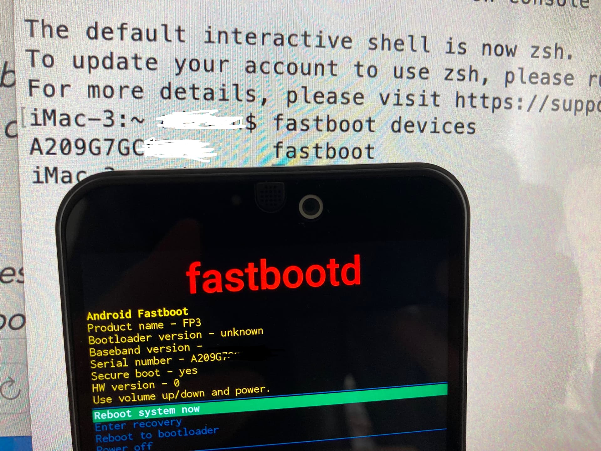

Presumably as you are intending installing LineageOS did you ever get as far as unlocking the bootloader? Did you try installing the latest FP3 6.A.035.2 via fastboot? Forget about ADB for now.
Just to clarify the screenshot is not showing bootloader aka fastboot you need to install whatever using a cable connected to PC.
No
ADB would never work in fastboot.
For fastboot when using windows often the bootloader driver need to be manually installed.
