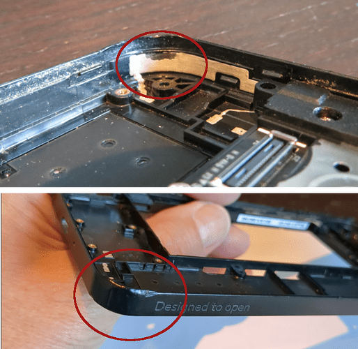

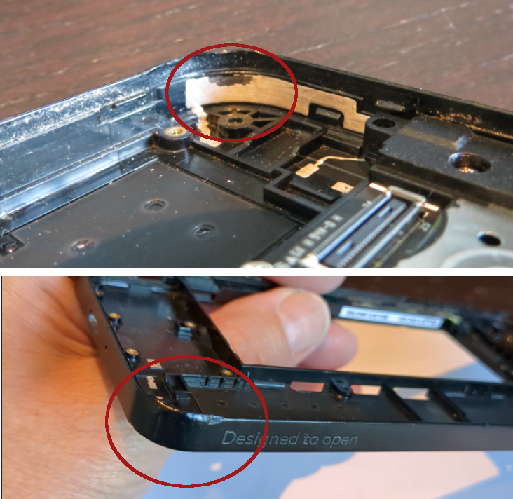

After that, I start to disassemble all parts and check the rear module where the antenna is located. And the problem was there, see picture below : the phone did fall down one day and antenna was damaged.
At least, I found the root cause. Now I have to find a new rear module to replace and fix the issue. Sadly, this part is not sold by Fairphone…
